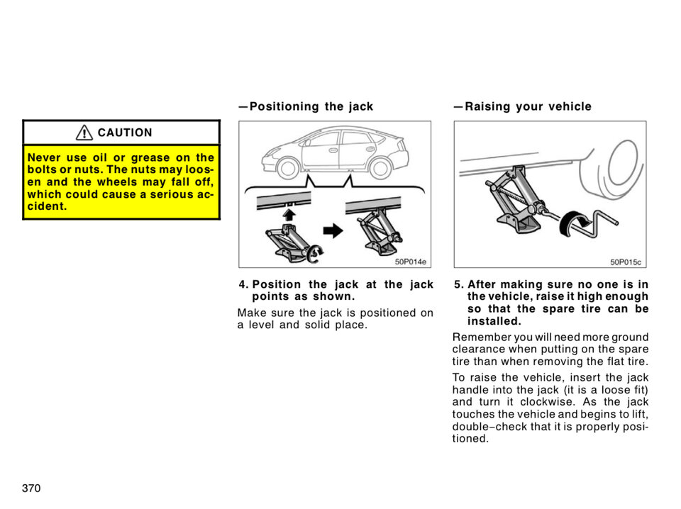

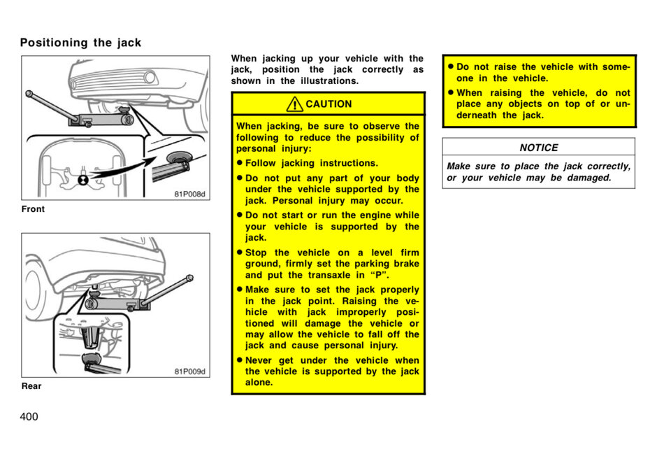

    Owners Manual is free at Toyota.com.
    Use of floor jack. Obtain low profile high reach floor jack for low vehicles like a Prius.
    After raising one end with floor jack, insert jack stands at locations on sides with notches
    Lower floor jack slowly on to jack stands
    Be sure jack stands are recent and solid. Some cheap Harbor Freight (among others) have been known to fail. Personally I keep the floor jack in place and lightly touching on the end I may be under. However full weight remains on jack stands.

    That instruction is for scissor jack though, not safety stands.
    If you place the Toyota supplied scissor jack thus, start raising, you'll see the bearing point is not on the seam, but on the sheet metal behind (and with a single use, it dimples that sheet metal, even on the lighter back end). The notch on the scissor jack cups around the seam, just brushes it at most.
    That seam is the same for it's whole length; there's no reinforcement at the scissor jack placement point, just the pair of notches to ID it.
    FWIW, I've had ours on 4 corners of jack stands, as I've described, at least 30 times now..
