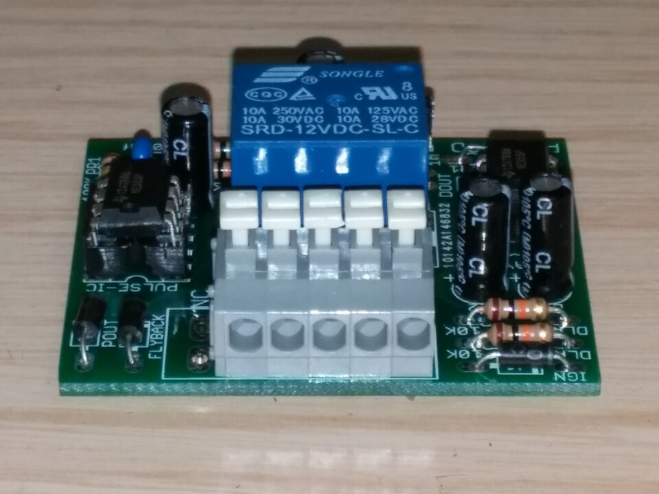

    There are debates going on with driving with power mode vs eco mode at
    I Like Power Mode | PriusChat
    2010: How do I make PWR mode default? | PriusChat
    Also driving in power mode does not necessarily mean saving or using more fuel. It's about keeping up with surrounding traffic and not pissing off other drivers for driving too slow.
    Just to remind you guys that this thread is not about driving in power vs driving in eco mode. This thread is about modifications on how to get the car into power mode when you first power up the Prius. AFAIK, my method is the only way. There's no other known way to do this, not scangauge, not even Techstream. Also this mod is strictly informational. You don't have to use it if you don't want to. No one is forcing you to do this mod. However, it is here when you need it.

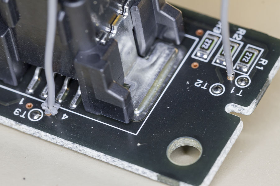

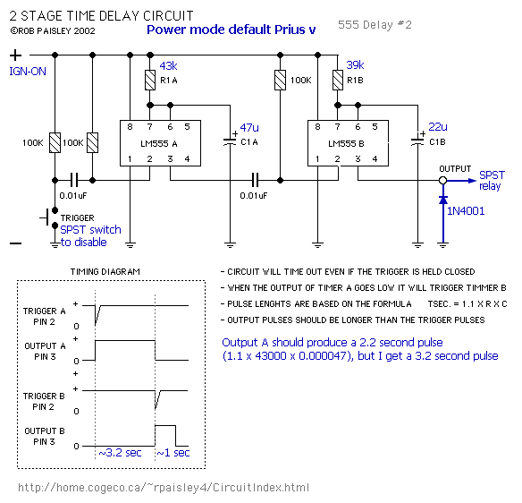

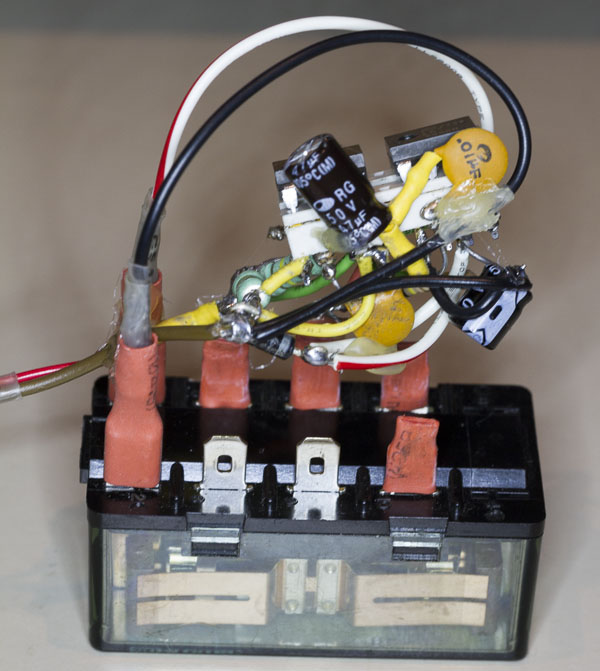

    cproaudio - Thanks for the research for the override. I used two 555 timers to get it to work. Power mode override 2 stage delay.png c07983.jpg

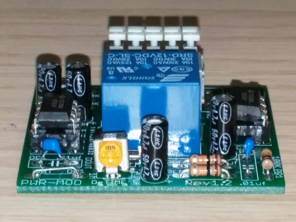

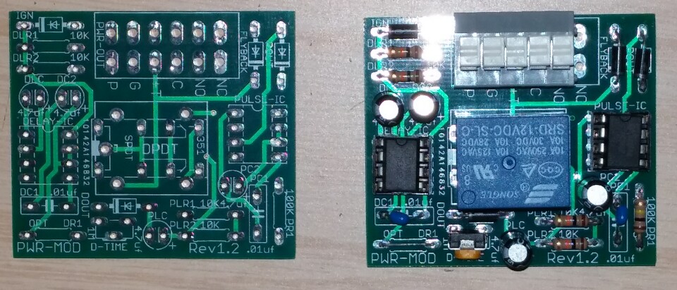

    Nice work. I also have a PWR mod based on 2 555 timer. My output A is adjustable from 0 to 5 seconds. Output B is just under 1 second. Do you have wiring information for the v?

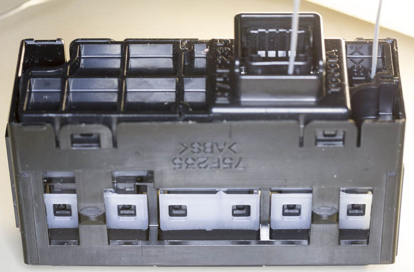

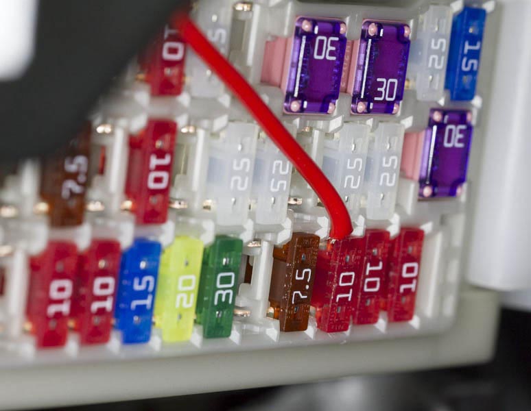

    Thanks. Not too pretty but it works. Open center console lid. Pry and lift at back of black cup holder with the 3 buttons. Disconnect harness and remove bottom. Solder to points shown and drill one hole. Route the 2 wires as shown. Replace bottom. Replace cup holder. IGN is fuse 28 at driver's side fuse block. The outside is +12v and the other side is fused. Not having a schematic to find the IGN wire nor could find this on a Google search, this is next best thing.
    The one thing I have noticed on all forums is that people tend to overkill by using heavy duty wire. I used 26 gauge solid and soldered to the board, then extended with stranded 24 AWG to the relay placed behind and to the left of the USB port. Most everything is 24AWG.
    If I didn't already have that DPDT relay (25 years old at $3), I would buy a solid state relay.

    Sorry, I couldn't get the timing right so I have abandoned the project.
