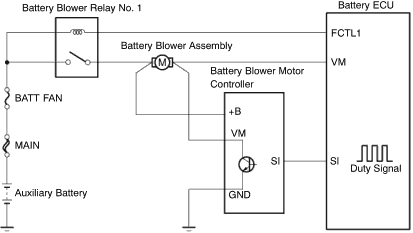

  5. ChapmanF
    27,619
    18,215
    There's nothing to rectify: the power source is already DC and the fan motor runs on DC.
    The controller in the duct is not much more than a nice heat-sinked transistor, able to take the pulse-width-modulated SI speed signal from the ECU and drive the fan motor with it. Indeed, your ability to alter the fan
    speed manually confirms it is fine.

  8. Frankusa94
    Frankusa94 Junior Member
    Jul 4, 2024
    60
    16
    Ma
    Thanks for the schematic! This is helpful...
    Today I attempted a ecu reset by removing the ground cable from the 12v battery for 5 minutes. This seemed to clear the ecu as removing the 5amp 12v battery fuse did not clear anything.
    Now I noticed that toyota ecu will control the fan ...speeds 1-3 ... around 100f fan is at speed 1, at 106f fan speed is at speed 2, at 116f fan went up to speed 3. This is better...but not good enough as the center hv battery bank was red at 121f ...the 3 banks were as follows. 117f, 121f, 116f.
    Once I launch and enable Auto fan control on hybrid assist app... fan speed goes to speed 6 (Maximum) and battery temps begin to drop toward 102f over a 20 min period... this is ideally were the battery accepts the maximum 25 amps regenerative or engine charging rate.
    I wish I could see what the toyota fan controller speed set points are... suspect only toyota service center can do such...

    27,619
    18,215
    The same repair manuals that the Toyota Service Centers look in to see what settings they are able to change with Techstream, we are also able to look in, and "fan controller speed setpoints" aren't there.
    Lots and lots of setpoints in the car are just hardcoded in the firmware. You can change the auto headlight turnoff timer in Techstream, but not the intake valve timing setpoints, for example.
    It appears to be the same with the battery fan speeds. You can override the ECU's choices with something like Hybrid Assistant (for as long as Hybrid Assistant is plugged in and actively doing that), but changing the ECU's setpoints does not seem to be a thing.
    Without reflashing the firmware, I mean. Of course in the tuner community people do all kinds of things by modifying the firmware and reflashing it.
