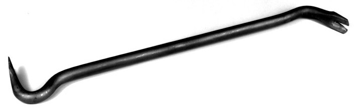

    <div class='quotetop'>QUOTE(KTPhil @ Jul 16 2007, 03:53 PM) [snapback]479877[/snapback]</div>
    Man that's pretty brutal just because the battery is dead!
  6. patsparks
    Jul 12, 2007
    10,664
    567
    Adelaide South Australia
    That isn't for the door!!
