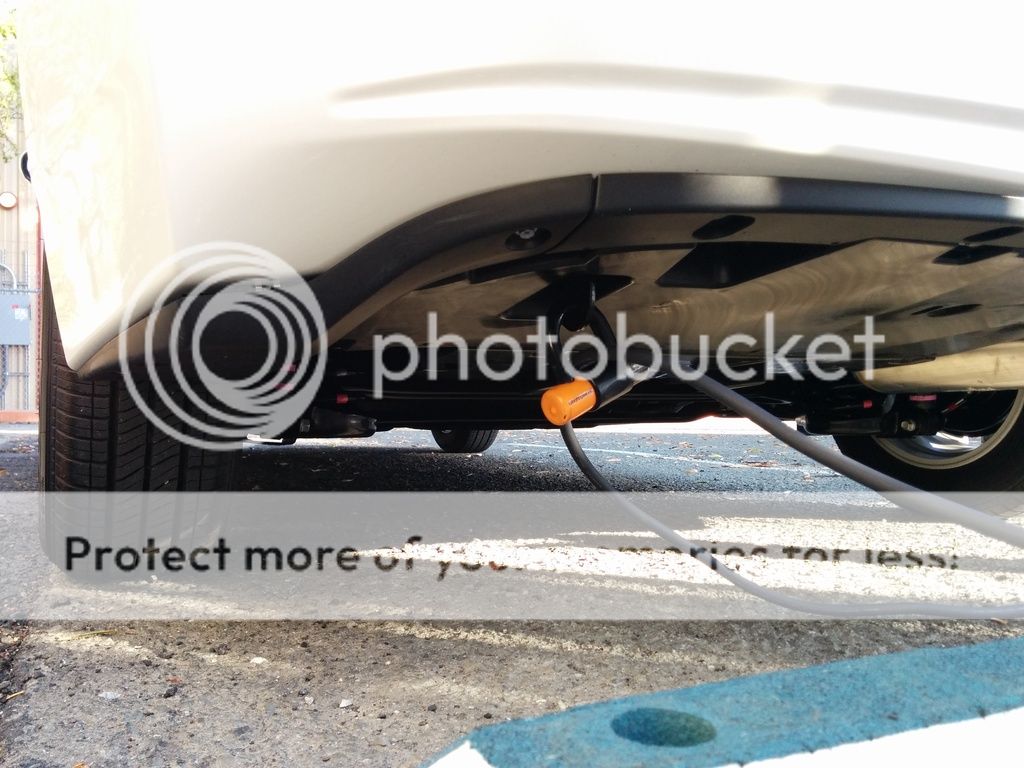

  5. ft3sfty
    ft3sfty Junior Member
    Apr 3, 2015
    20
    Martinez
    2015 Prius Plug-in
    I lock my charge cable to the bottom of my car with a small U-lock. Granted, thieves or vandals can still cut the cable.

  6. bisco
    115,383
    52,814
    some people drive on top of them, it's not a perfect system, but there's not much you can do if vandalism is the issue. idr anyone reporting a stolen evse here. any deterrent is enough to keep most would be thieves at bay.
