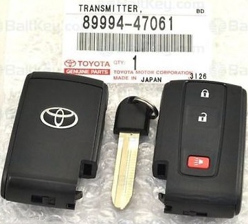

    I have a 2006 Prius that I needed a second key for. As recommended in this article, I purchased a brand new SKS key looked up via VIN Number at the local Toyota dealer - part number matched what is listed here - 89994-47061 - total price $142 and change. Cutting the emergency door key (in case the SKS and fob button functionality fail to work) is included in that price. They cut it from the first key, rather than doing so by VIN number (would have taken longer and required more paperwork verification).

    So I read 8 pages and saw nothing about a black logo working on the SKS. Just got a used 2006, came with only one FOB.
    I bought the 89904-47061 off Amazon (DaytonaToyota) and the logo is black, but with chrome outline. I was a bit anxious because I took this to mean I have the wrong FOB, as it is not chrome. (my old FOB black paint has worn off so it is now "chrome" - ha!)
    Paid $117.57
    Well it worked just fine. Took only two attempts to get my timing right. All smart key functions working perfectly.
    (Then, I found it for less after the fact, cannot recommend as I didn't purchase here but this may be a good tip at $74.95 2004 Toyota Prius - 89904-47011 or 89904-47061 Keyless Entry Remote, Key Faab)
    Thank you!

    Can you post a pic of the new key fob with the black logo outlined in chrome? On all fobs I've ever seen, the entire logo is chrome. Additionally, can you post a pic of your old fob showing where the black paint has worn off?
    All of this is news to me because every fob I've ever had, the entire logo was chrome. I've had a lot of fobs including, new ones, old ones, severely worn out ones.
    Thank you.
  14. brokerdelete
    brokerdelete Junior Member
    Sep 30, 2007
    44
  15. usnavystgc
    Jul 29, 2011
    3,159
    990
    Tucson, AZ
    Yeah, that is what I'm use to. The entire logo is chrome on that one.
