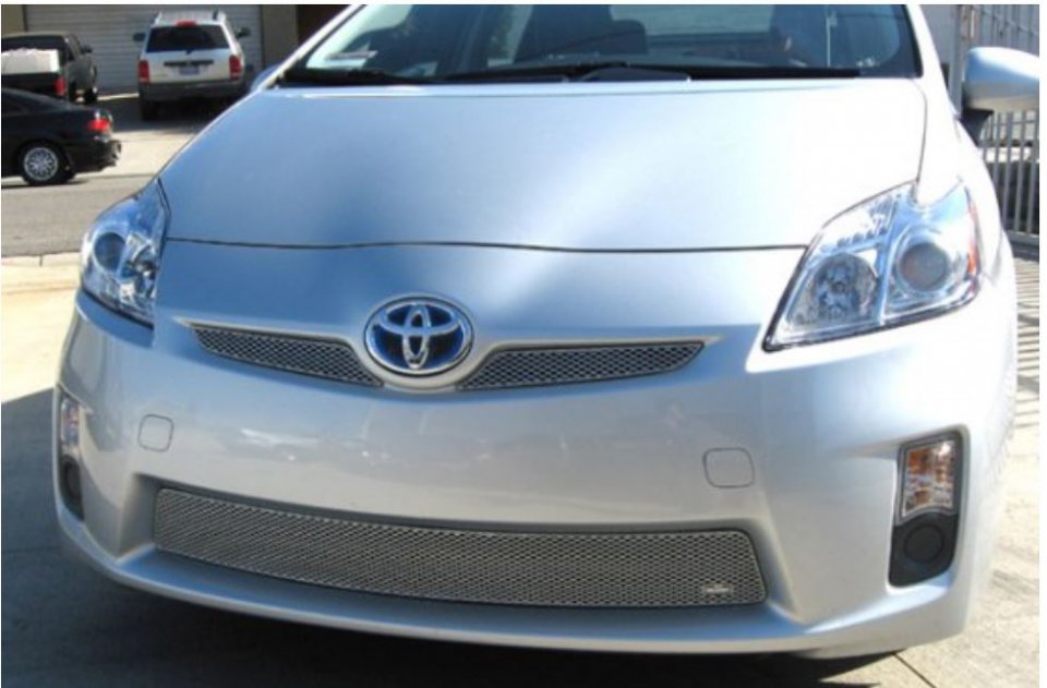

    Here's what I plan to do in the next 2 months...the total kit is about $350, but if you consider a stray pebble hits your condenser coil, you're looking at a $2000 repair:

    I purchased evestrough mesh. It's aluminum expanded mesh. Cut it to size and used black zip ties to fasten it to the back of the grills. It's hard to get in there to work, so I used some stiff wire to direct the mesh into position and installed the zip ties from the front. Looks good (the mesh hides behind the grills), and is inexpensive. It also stops most bugs of size.

    By the way, the Grill Craft Mesh inserts that phoenixgreg posted above is a great idea for this kind of trip.

    Off to google the Grill Kraft Mesh kit! (Sure looks better than my jerry-rig although it does not protect as much of the surface.
