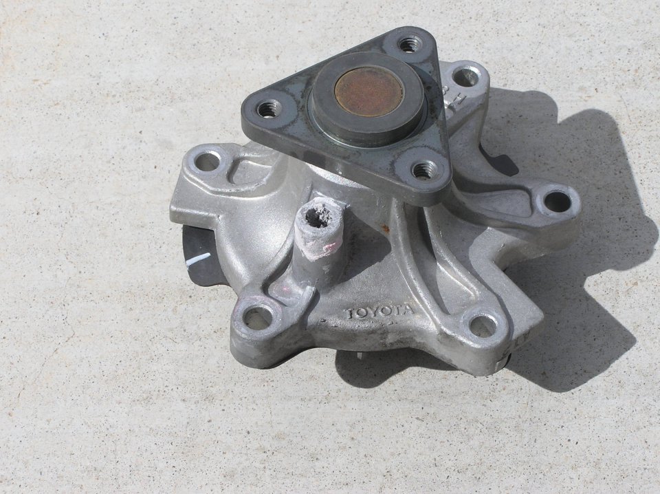

    IMHO, this alone is reason enough to stick with a Toyota replacement coolant pump. I originally bought a third-party pump which came with a paper gasket. When I started doing research on sealing it properly, using the silicon goop, letting it cure overnight, etc., I called the Toyota dealer to ask them how much their gasket was, figuring they'd have pre-treated it with whatever it actually needed. He didn't have one in stock, but he offered to go look inside the box of a coolant pump, which they did stock, to tell me about it. He came back and said it was metal! Sounded strange to me, but doing more research showed me that the metal gasket by itself should seal fine, with no cure time required. SOLD. I went and bought the Toyota pump. (Also, my original pump was still working - albeit noisily - at 290k miles. Would the aftermarket pump last as long? Who knows? I returned it for a full refund.)

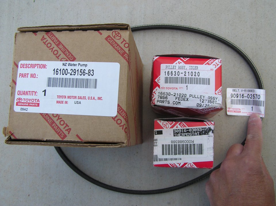

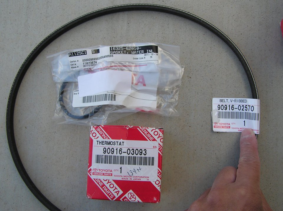

    I realize this is an old thread but wanted to ask what else would you change when doing the engine coolant pump? This is purely preventative as my 2005 Prius has 255K miles and the pump (and serpentine and coolant) was last changed at ~150K. As far as I know, I don't hear any issues - no loud squeals or grinding but I've always heard it is best to change the pump before a breakdown occurs. So if I'm doing that, then what else is good to change since the coolant will be drained anyway? I never thought to do the idler pulley and thermostat until reading this thread, so makes me wonder what else is good to change. Any sensors I should be worried about?
    BTW - I was surprised the idler pulley is as much as the water pump - this is from 355 Toyota Darcars in Rockville. I also am doing the transaxle ATFWS fluid and inverter coolant and pump

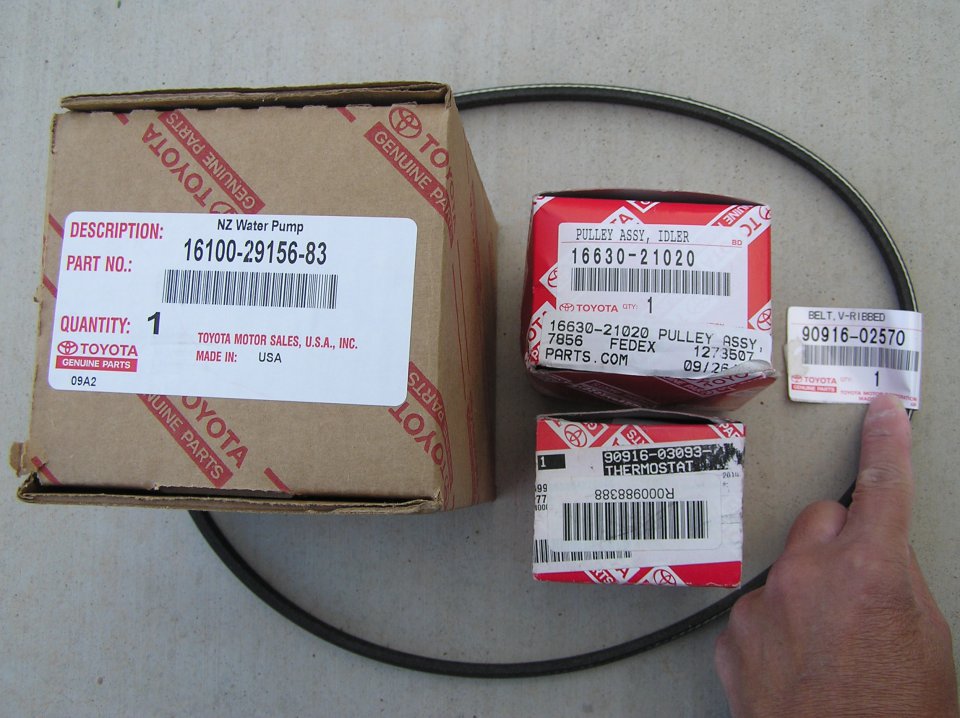

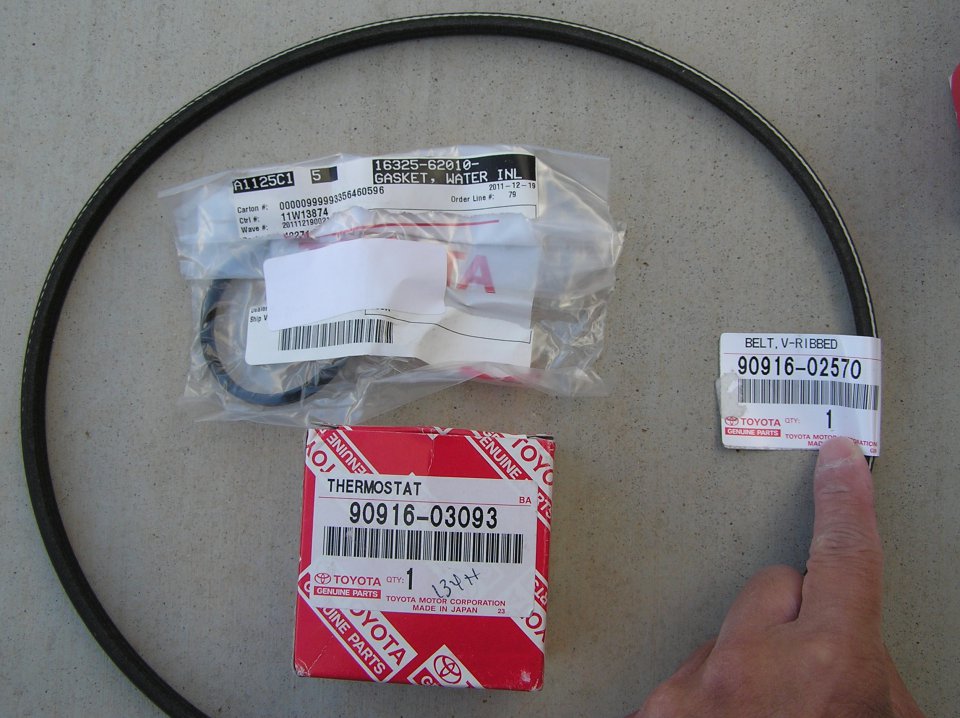

    P/N Quantity Price Each Description
    1632562010 1 $ 5.31 GASKET, WATER INLET HOUSING, NO. 1
    9091603093 1 $ 21.56 Engine Coolant Thermostat
    1663021020 1 $ 58.36 Accessory Drive Belt Idler Pulley
    161002915783 1 $ 56.69 Engine Water Pump
    9091602570 1 $ 8.44 Serpentine Belt
    G902047031 1 $ 120.10 Drive Motor Inverter Cooler Water Pump
    9043018008 3 $ 1.43 Transfer Case Shift Shaft Seal (Front, Rear)
    00289ATFWS 4 $ 8.45 Genuine Toyota Automatic Transmission Fluid-WS
    00272SLLC2 2 $ 15.40 Toyota 50/50 Pre-Diluted Super Long Life Antifreeze/Coolant
