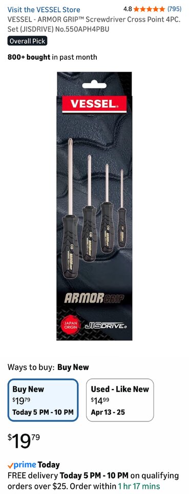

    I would take a #2 JIS screwdriver, probably a set.
    JIS is not the standard #2 Phillips. Phillips look similar but are designed to cam out (slip out) at a specified torque.
    A JIS will not cam out and was designed in Japan for the fasteners used in their cars.
    Vessel is the best brand. Most US local stores don't have JIS.
