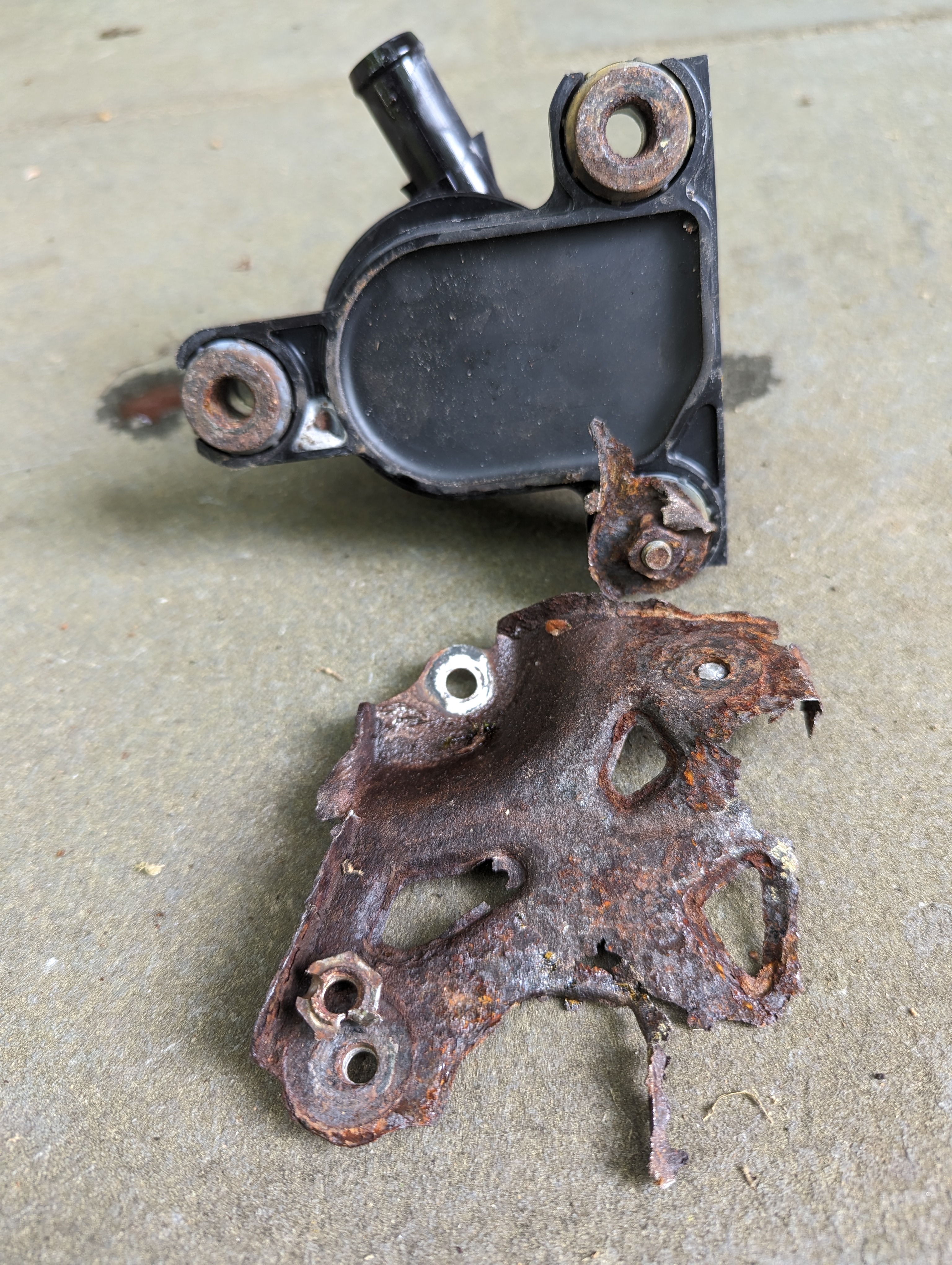

    Pump replaced as part of recall in 2011 at 63k miles. Now replaced again in 2024 at 145k miles. You can see from the rusted out bracket I'm getting water in the engine bay. Everyone on YouTube rattling off the swap in thirty minutes flat, but it took me an hour just to drill off the stripped nut (bottom left). You can also see a sheared bolt. I wasn't about to reverse-out the third stripped bolt, so I left it there and ziptied that corner to the fuse box.
    I bled the system for a good ten minutes and bubbles never stopped. Screw it, I said, there's a million gen2's running on moribund inverter pumps anyway.
