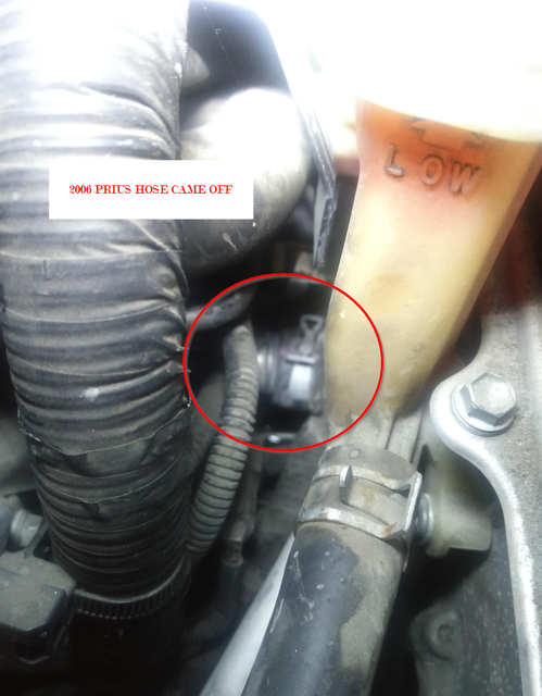

    For some reason (TBD) my upper radiator hose seems to have fallen, or blown, off. Hopefully not a bad head/head gasket. Haven't seen any other indications of that. No codes.
    Anyone have instructions or some type of game plan for putting the hose back on without removing half the engine? I even have a pair of those extended hose clamp pliers, but I can't really fit in there to get the hose back on.
    Here's the problem....

    That reservoir is for the inverter, not the engine. I think you should figure out why the hose came off. Either the reservoir plastic cracked or the hose failed. Plan to replace whatever actually failed.

    It's not the reservoir being highlighted in the image.... look at the hose clamp within the red circle.

    I am looking at the hose clamp within the red circle. That hose does not look like the hose connecting the engine to the radiator because 1) the diameter of the hose opening is too small and 2) the hose is pointing in the wrong direction to be connected to the engine cylinder head.
    However it might be the hose that connects from the inverter radiator to the inverter. Can you get a good photo of the spout that the hose is supposed to mate with?

    Absolutely. It's this connector right here:
    (I guess it's directly below the coolant temp sensor?)

    If you look at the 2 pictures, you can see the ribbed aluminum edge of where the hose goes on in each. The diameter looks like a little bigger than 1".
    I looked at it a little closer this evening. I think if I unbolt the inverter reservoir I might be able to get to it. 300k miles though... might as well replace the hose and the clamps while I'm there. If there is a compression or head gasket issue, new parts should make it work harder to blow it off next time? :D

    You may need to remove the inverter for access.
    I suggest you plan to replace both radiator hoses connecting to the engine, and the thermostat.

    I think I might be able to get away with just removing the inverter reservoir tank. Going to tackle it today. I will definitely replace that hose, clamps and thermostat. I'll update later if it was successful or not.

    Just being a wag: if that's the upper hose, I'd hate to be dealing with the lower one...
    Which got me thinking: would it be easier to deal with from below, if you raised the front or ran it up on ramps? I appreciate the clamp prongs are at 12 o'clock, but maybe they could be rotated.

    Yeah from above starting to look like inverter would need to removed, or moved.

    Definitely the lower hose. #13 on the parts list.

    confusing. The part is "lower" hose to toyota. But everywhere else lists it as upper.

    Got the hose out w/o removing inverter. Very difficult. I'll see what I can do to video putting it back in.
