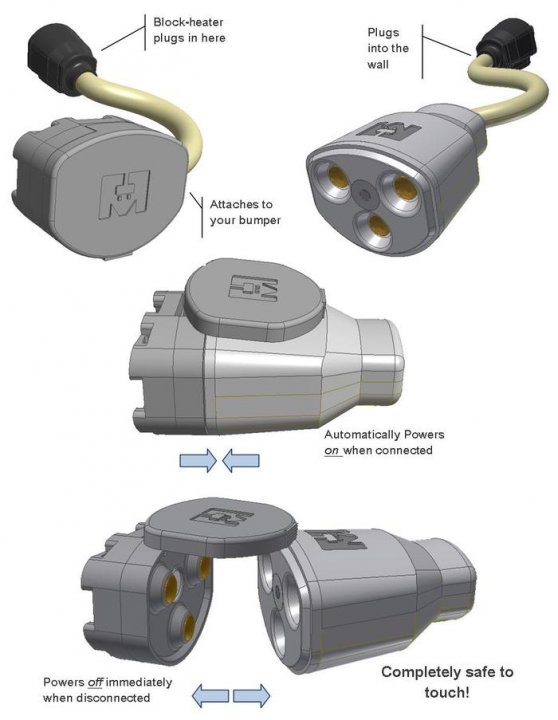

    I t depends in the kind of solution you are looking for.
    Temporary, and extension cord trough one of the windows. More chances that you will see the cable and do NOT drive away with it connected to a power source.
    Sort of permanent install, trough the rear vent, behind the Aux battery or the opposite side of the vehicle, near the gasoline inlet.
    You could use one of this PLUGS when they become available.
