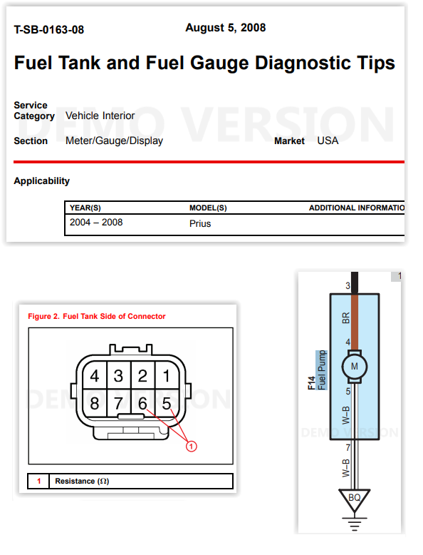

    Just used this thread to drain bad fuel from my 2007 Prius. YT has a couple vids that show where to find fuel quick connect. Had some 5/16" ID tubing - fit perfectly. Used this diagram to id pins 3 (hot) &7 (ground) at fuel tank connector under left rear seat.
    Using a 12V battery to energize pump, emptied full tank in about 20 minutes!
    Thanks to all who post. Helps me keep my '07 running like a champ.
