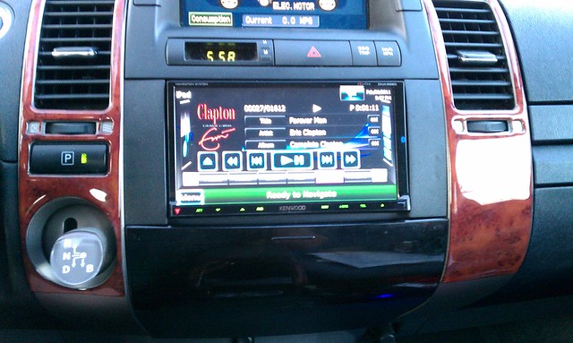

    Well, that's done, at least in a basic form. I've got the radio working (the sound is quite better already) and GPS too, not the wheel control, though it looked like it was correctly programmed: probably that 12V cable, though I'm not sure what you call the head harness; I haven't received the buttons yet either.
    Here are a couple of picture during (looks pretty scary) and after. It all went pretty well thanks to the docs. I haven't any screws left, which is rather a good sign.
    The first time I tried to close the dash board I noticed there was a rather large space above the JVC and not enough below, but when the double DIN module is shifted to the upmost position and tightly screw, everything seems to fall into place with almost no gaps. Nice. The mic cable runs along the passenger A pilar, and I then fished it under the dash board, probably quicker than to dismantle the whole thing.
    As a side note I've been fishing a triple RCA to the central console, in order to output video to headrest monitors. I've installed a pair last summer for a cross USA/Canada trip, but I removed them because my priority was to improve the sound. I might reinstall them now, if I figure how to play a video while driving. So on top of that I'd like to use a bluetooth phone and maybe figure how to use a PMP to play and input audio/video in the system. Also I haven't connected any of the reverse (for backup camera?...) , parking brake (for video playback limitations?), or speed signals... maybe later.

    Great job! The last pic looks very clean. Would love to see both screens powered on!
    For SWI-JACK, the black (ground) cable has to go to your head unit's black cable. Otherwise, you can't program it. It won't successfully remember the first button you programmed. Sorry, I should have remember to mention it before.
    I will update the document when I get a chance.

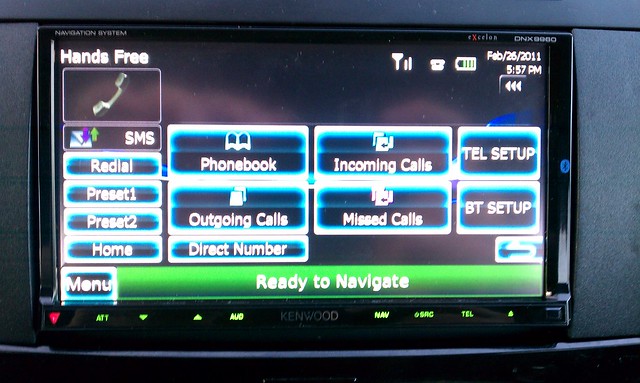

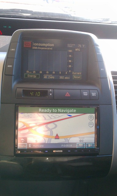

    I have a bonus for you: 3 screens! I was using my Archos to play an audiobook via the front AUX this morning. Don't bother with the awful mileage, it was quite chilly this morning.
  11. usbseawolf2000
    usbseawolf2000 HSD PhD
    Sep 22, 2004
    2,999
    Fort Lee, NJ
    Awesome! I put my iPhone 4 in the tray also. Please change the color of the button/knot illumination ;)

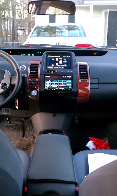

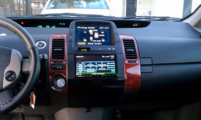

    Per seawolf I am posting my install here.
    This is a Kenwood DNX-9960 with the same install kit seawolf used.
  20. usbseawolf2000
    Sep 22, 2004
    2,999
    Fort Lee, NJ
    Beautiful! How fast is the boot up for 9960?
