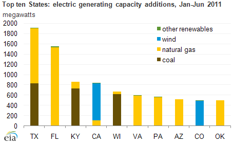

    If you want to see the greening of the grid, look at what was added in the first half of 2011.
    (frmo http://www.eia.gov/todayinenergy/detail.cfm?id=2690)

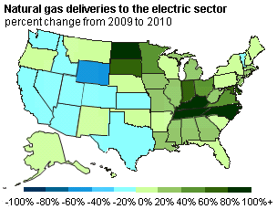

    Here is a plot of changes in NG for generation
    from http://www.eia.gov/todayinenergy/detail.cfm?id=4350
    I agree it may be a decades until the grid average is < a NG gas grid, but EV's will be will be way cleaner than gasoline long before then.

    Thanks for the new capacity graph in H1 2011. All I can say is we better hope NG stays cheap, because the 'greening' is just a happy coincidence of current competing fossil fuel wholesale costs.

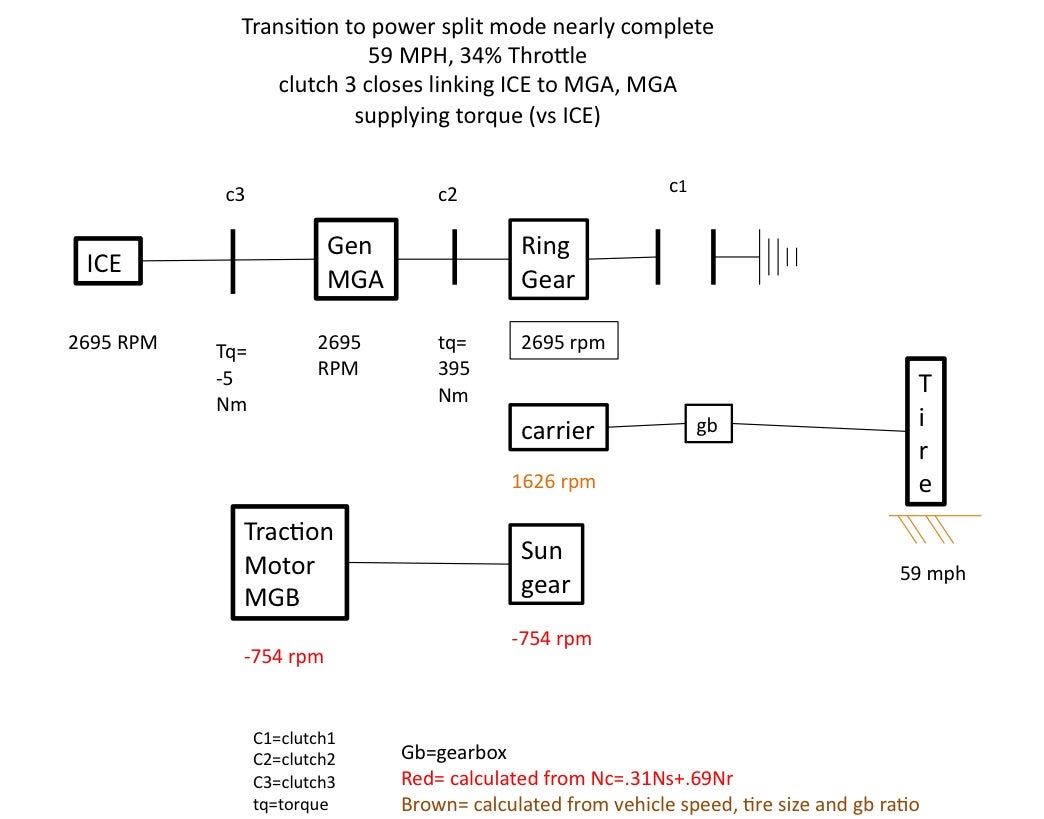

    There was 8 seconds between 55% and 32%. The speed increased from 50 mph to 58 mph during that time. How can you conclude he was trying to slow down and regen kicked in?
    One thing we can conclude is that, MGb is spinning the opposite direction as the gas engine. I was right all along. Does that mean the YouTube video showing the computer model of Volt transaxle is incorrect?

    Maybe because he had 55% accelerator at the beginning and 32% at the end. Having driven a car, I know if you back of 20% of the accelerator pedal you are trying to slow your acceleration and maybe speed. In a Volt, depending on how back off it will generate regen though there is no way to tell from the data how fast the driver backed off.
    The video model would be correct. There is nothing in a table of number that will let you conclude the actual direction of rotation.

    Are you saying schematics #5 to #8 are incorrect?
    Schematic 5:

    5 looks like a mathematically possible combination, but unlikely an optimum one from a power point source point of view, unless you are trying to charge the batteries from the ICE. Are you saying someone measured those numbers in a volt? Was the software attempting to charge the battery?

    Negative RPM on MGb means the car is doing Regen.
    It does not say if the rotational direction is with or against the ice.
