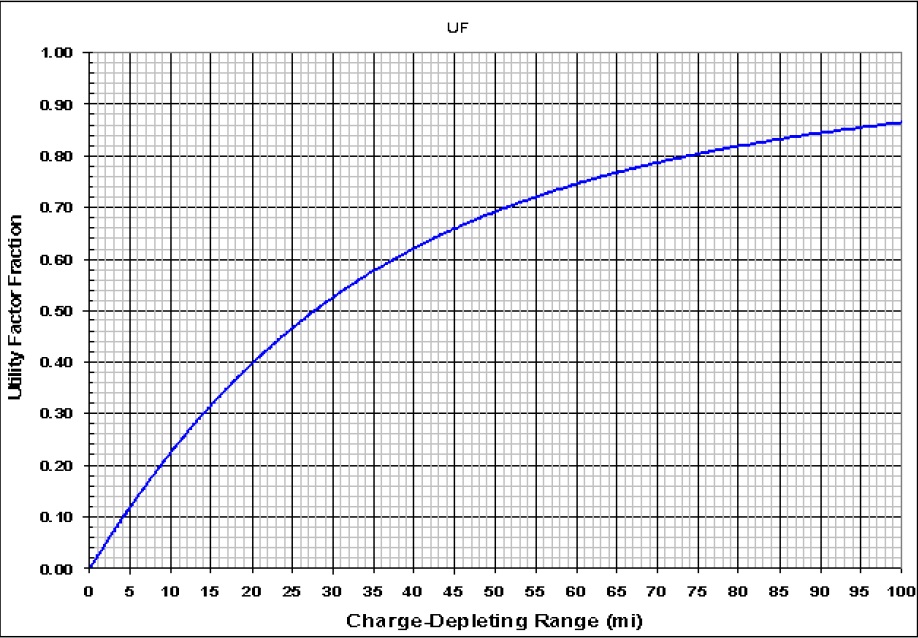

    42% statistic is from the utility factor of SAE J2841 standard, revised in 9/2011. It predicts that 35 miles EV range would cover 58%. The data is from 2001 U.S. DOT National Household Travel Survey.
