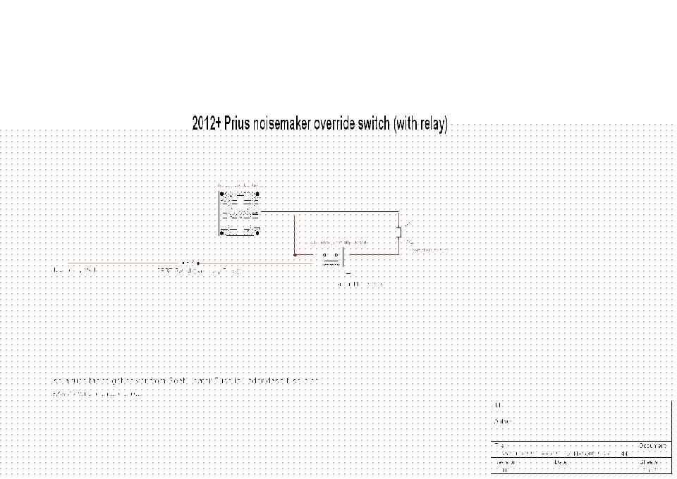

    By using a relay, the OP could control the circuit using only one wire through the firewall . The switch in the dash would be between a 12V positive wire (Ready Mode) and one terminal of the coil in the relay. The other coil terminal would be grounded near the relay.

    I'm at work now and posting from my smartphone lol. I'll post a diagram L8R.

  10. xliderider
    xliderider Senior Member
    Apr 19, 2012
    8,140
    3,280
    Honolulu, HI
    I realize that. I just pointed out that by using a relay, one wire instead of two needs to go to the switch from the engine compartment.

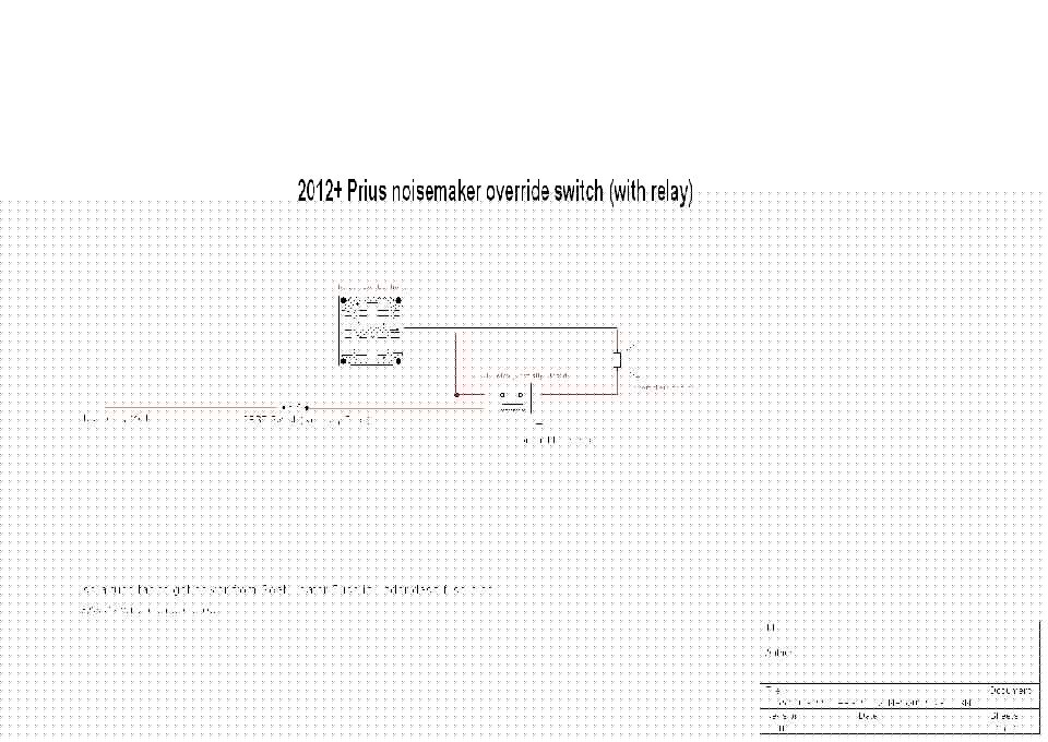

  14. xliderider
    Apr 19, 2012
    8,140
    3,280
    Honolulu, HI
    Disclaimer: I take no responsibility for any damage caused to your vehicle, or injury to yourself or anyone else. Modify at your own risk.
    Here's a diagram of the setup using an SPST relay, advantage is only one thin 18 gauge wire needs to go through the firewall (click on image for larger view):
  15. GasSaver1
    GasSaver1 Member
    Jul 12, 2009
    220
    20
    South Florida\Long Island NY
    Yes same concept and will work.
    + easier to get the wire into position past firewall
    - you have to tap power from another source
    - you have to introduce additional hardware (relay)
    + safer as the circuit is isolated (though it is probably only 12v or 24v, such low voltage to power the speaker it wont hurt anything anyway)
    *still running voltage through the switch
    But overall same concept and would function exactly the same way. People can go either way with this
    EDIT
    but just keep in mind that either you have to splice into the engine harness OR the speaker harness to wire up to the normally opened contact of the relay as pictured. If you choose to splice into the speaker side harness it is not very long as can be seen in my pictures so either the relay has to be right there (maybe even secured to the speaker), you would have to solder in extension wires, or you have to cut and wire into the engine harness side to make this all work.
  16. GasSaver1
    GasSaver1 Member
    Jul 12, 2009
    220
    20
    But also as pictured, you have it set so that when you press the button in, it will disable the sound. (you are showing wired to the normally closed) So pressing the button in energizes the coil of the relay causing it to pull in and breaking the + voltage from the controller to the speaker.
    Mine is flipped, when the button is not pressed in, then no UFO noise. When I want to activate the system I push the button in.
  17. xliderider
    Apr 19, 2012
    8,140
    3,280
    Honolulu, HI
    Can go either way with a normally open or normally closed switch or relay, just have to wire accordingly. :)
    The diagram has a normally closed SPST relay in it. But as stated above, either a normally opened or closed relay can be used, the user just needs to enable/disable the switch contact in the dash accordingly to gain/dsiable the noisemaker function as (s)he chooses. ;)
