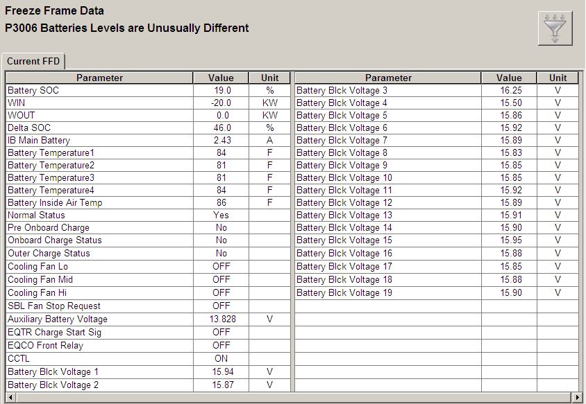

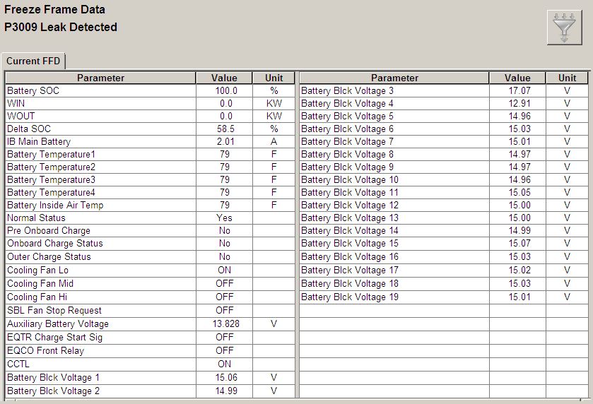

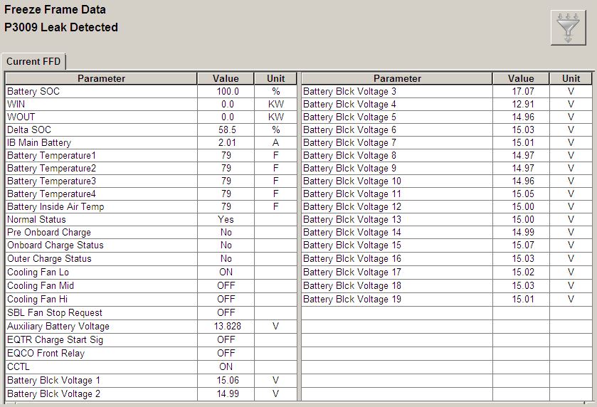

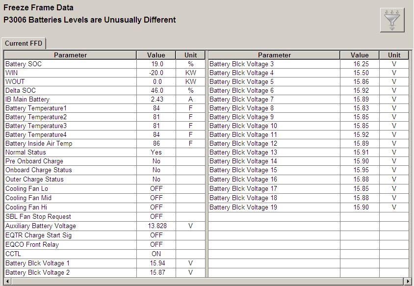

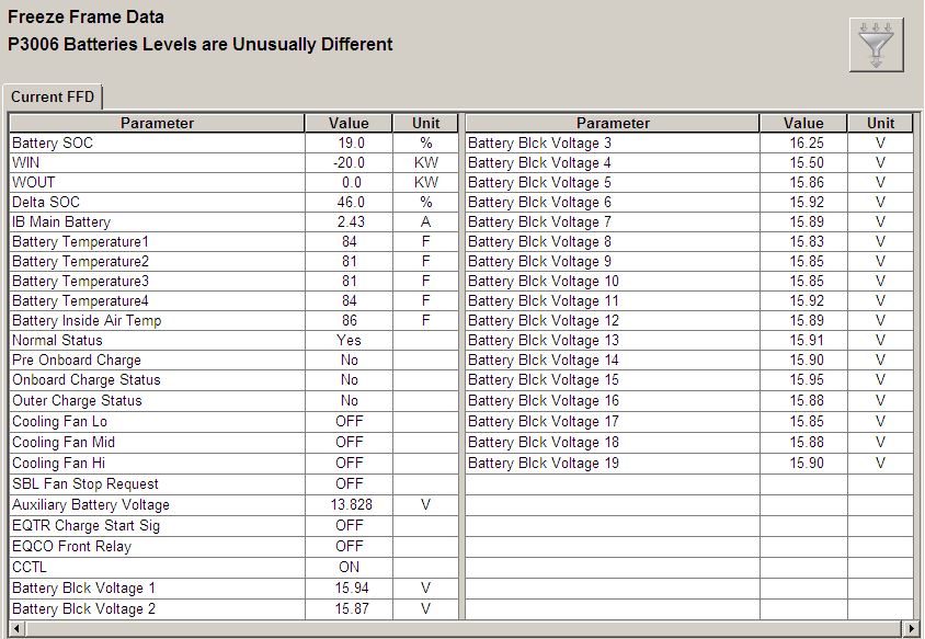

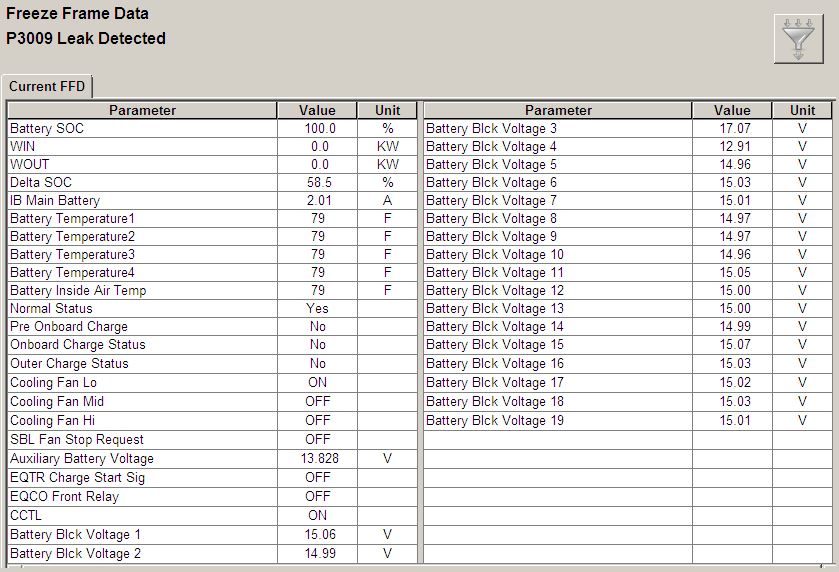

  7. Rim
    Rim New Member
    Jun 23, 2014
    Fairfield iowa
    2001 Prius
    Tim helped me out getting stats
    Can someone help with what would be best to do next
    Thank you
  8. bwilson4web
    29,063
    16,523
    Each battery module consists of six cells of ~1.2V each and there are 38. Their voltages are measured in 19 pairs of modules. Anytime you see one pair of modules off by 1.2V or more, then there is at least one failed cell. It will never recover.
    When the module fails, it runs hot and that heat causes adjacent modules to fail.
    This data suggests module 3 and 4 are marginal with at least one cell failing.
  9. messenger
