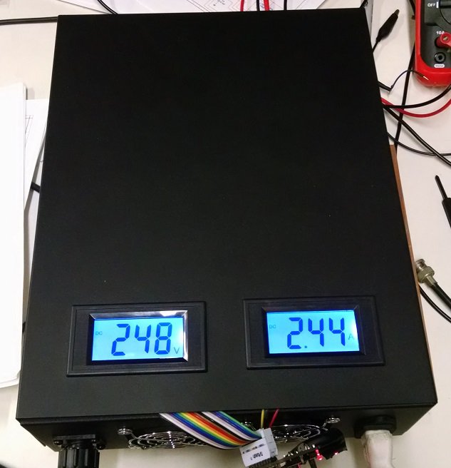

    Hello. Thanks for the great questions, and for the email to help me find you post ;-) The intelligent discharger is getting close, and I must say is very cool! We have working prototypes done, and are just working out some final thermal issues. Here is a pick of one of the test units drawing 2.44A at 248V:
    The Intelligent Discharger will automatically taper the load down as the pack drains below its normal operating range. You simply set it to the termination voltage you want and then walk away! It will do the rest. They are probably 2-3 months away from full release. Our beta program is fully subscribed but if you want to be on the interested parties list (first to know when released) send us a note. Once our last QC tests are done we just need to ramp up for production.
    The simple light bulb based dischargers we sell now work great, and will be much less $$ than the Intelligent Discharger unit. For those that want to save some funds and are ok with changing the lights bulbs at the proper intervals while the battery drains, this is and will remain a great, cost effective option.
    It allows for remote turn on and turn off of the charger system. It will also monitor AC wattage consumed by the charger. It's a fun toy that some people really like (and we are happy to supply), but is not necessary for reconditioning the battery pack with our charger & discharger combination. You can read more about what the Belkin Wemo is and what is does here:

    With Eric's help, I've got good replacement modules and have the pack together and installed.
    Jeff, I'm on a learning curve with your charger and discharger. I had expected the voltage to top out at 240. I was away for a bit so, wasn't able to follow the charge closely, at all times. But I did notice it get to 239. Then, it came down and seemed to want to stay at 235.
    After about 24 hours, I pulled the plug to focus on discharge. I got the 200, 60 and 15 watt bulbs. Took a bit of looking because some were called replacement bulbs and actual wattage was less. Most of the 60 watts actually used 43 watts. If I understand your site's guide, it can take less than 4 hours to discharge. I think it took about 2 hours just to get to 196 volts. And maybe about 6 more hours to get to 140v. I understand that every pack is different but just wanted to run this by you to see if this is an odd situation. I have noticed a jump back up in voltage after inserting the next set of bulbs. Maybe 10 volts. Now that I'm using the 15 watt bulbs, I'm not really sure how low to take the pack. I think you've mentioned .68v per cell as being the minimum for measurable impact. I assume you mean around 115v for the pack? 115v divided by 168 cells being .68v. Is that how to figure the individual cell voltage in relation to the pack?
    If I'm on the right track, I assume I'll do this 3 times, finishing with a 4th charge. What's a good step down voltage for the next 2 discharges?

    After about a 11 hour discharge, I think it's complete. With my target of 115v, the last few volts went quickly and I stopped at 114.3v. I plugged the charger back in. The cooling fan control sub-assembly seemed to run with a high pitch for 5 seconds or so, then went silent for a few seconds, then started back up with a steady but lower pitch. I think the battery fan ran steadily during this episode.
    I noticed the voltage on the charger started out at about 125, then, within a few minutes, hovered around 150 but moved around a lot between 144 and 152. Back and forth. All this time, the mA would swing wildly from around 360 to 0 and back again. Is everything as it should be?
    Now, about 10 minutes later, the voltage is reading just under 200 and moving very slowly. The mA are fluctuating between 120 and 300 with an occasional 400.

    Sure, happy to help. The peak voltage of the battery will vary. It varies from battery to battery and even with the same battery depending on a variety of factors, such as ambient temp, charge level of the battery when you began the process, battery health, as well as other factors. 235V-240V is right in the normal range of what I would expect to see on a 04-15 Prius battery pack. Yes, traditional incandescent bulbs are getting harder to find. The CFLs are more common, but do not create enough load to discharge the battery. We have found that the local 'mom and pop' hardware stores (such as Ace Hardware) tent to keep a better supply of incandescent light bulbs on the shelf.
    The discharge example on the website that took just under four hours was not a deep discharge, but just a operating range data logging example. We normally see deep discharge times of 6-10 hours depending on the battery pack. Your discharge times sounds normal. The voltage bounce back is also normal. When you remove load from the battery cells, they will recover and you will see the voltage rise. The opposite happens when you are charging to high (100%) charge levels. When you disconnect the charger you will see the voltage drop back into the normal operating range as well.
    You are correct that you need to go below 0.68V/cell to get the best impact. When we do ti, we drain to 100V, then 50V, then 10V for the Pack, charging for 24 hours between each deep discharge cycle.
    Yes this is correct/normal/ok. The current will fluctuate when the voltage is below 200V. It will automatically normalize at 350mA when the voltage crosses over 200V. The power supplies inside the charger system can only regulate current over a 50V range. The fluctuating current below 200V averages to about 200mA and is still quite safe for the battery. Has the charger crossed back over 200V yet?
