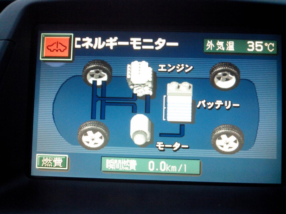

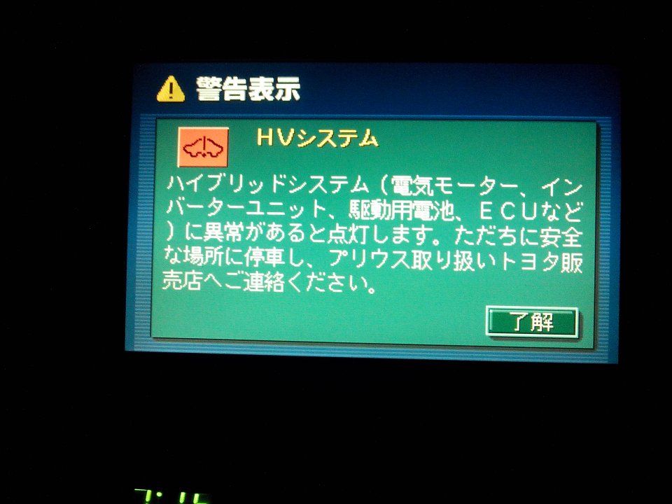

    I was driving my car fine suddenly ac stopped cooling nd these signs appeared. I am uploading the pictures. Please help if anyone can.

    Although I cannot read what is on the screen, there are two things I can suggest, if you can answer the questions below.
    (1) Have you had work carried out on the A/C recently?
    (2) Can you see turbulence in the inverter coolant tank when the car is made ready? This is the white plastic container between the engine and the large silver painted box, with red/pink fluid inside.

    If there is no movement in the fluid assuming there is fluid in the container and you cannot reasonably hear the pump, it is the pump that has failed. This causes the inverter to overheat it then shuts down anything that uses power from it starting with the A/C and then the 12 volt charging system. The best way to check the pump is by removal t see if it will pump water with a 12 volt supply. However I am reasonably certain this is your problem.
