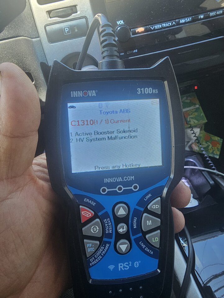

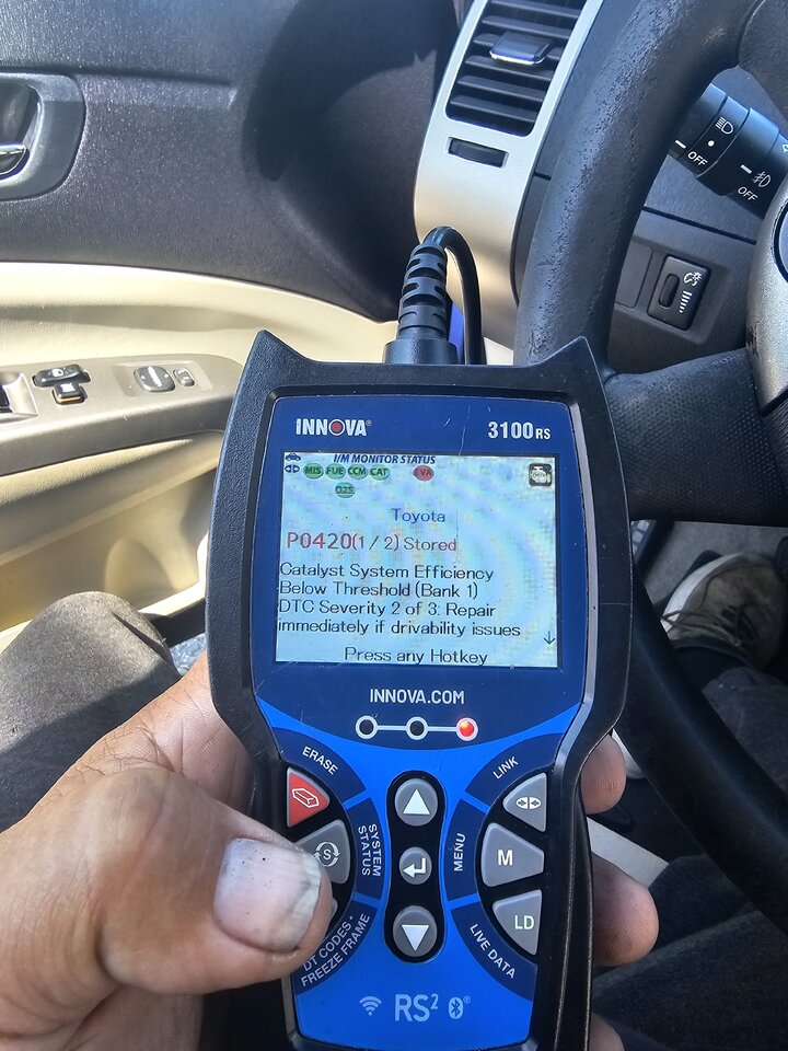

    My car was fine, the hybrid battery was fine before the Catalytic was stolen, my daughter had to go work so I bought a cheap Catalytic and o2 sensor just for the noise. but after few miles it popped red triangle, VCS, CEL and (!) lights, I plugged my OBD2 reader and shown P0420, but in the ABS menu it gives me C1310 Active Booster and Soleniod HV System Malfunction.

    Check the O2 sensors (especially the one you bought), and maybe the wiring under the car. Cat thieves aren't known for their quality treatment of the cars they handle. I may be wrong, but I would think if there's a problematic reading from your O2 sensor, it might show up as a catalytic converter efficiency problem. I'd have to look it up, but I would think just about any OBD2 diagnostic tool should give you the pre and post-cat O2 readings. It would take a more robust tool (with bidirectional capabilities) to check the heater circuits too.

    The Toyota description for code C1310 is "Malfunction in HV system". This code is reported by the ABS system, and it just means that there is at least one trouble code reported by the hybrid control system (ECU). It appears that your scanner is not able to talk (communicate) with the hybrid control ECU, so it is not capable of telling you code for the hybrid control system. I am guessing that the code is P0A80, which has the description "Replace Hybrid Battery Pack ". You need a better scanner that is capable of reading all the trouble codes in your Prius to determine what code you have in the hybrid control system.
    I think that it is a coincidence that the hybrid battery has problems one day after the catalytic converter was stolen.
    So I think you have two separate problems. One for the hybrid system and one for the catalytic converter.
