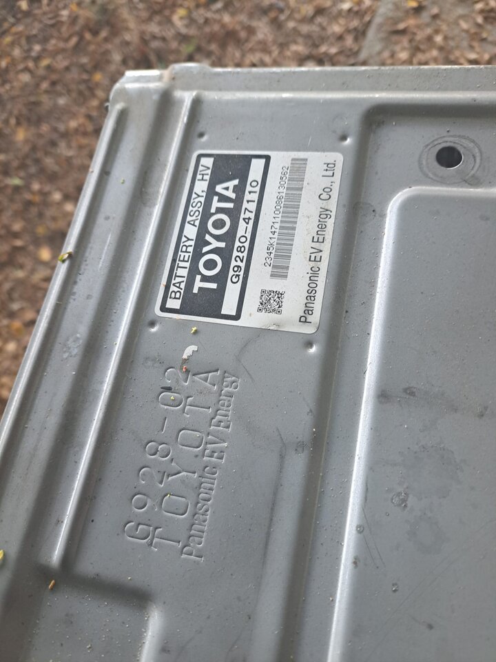

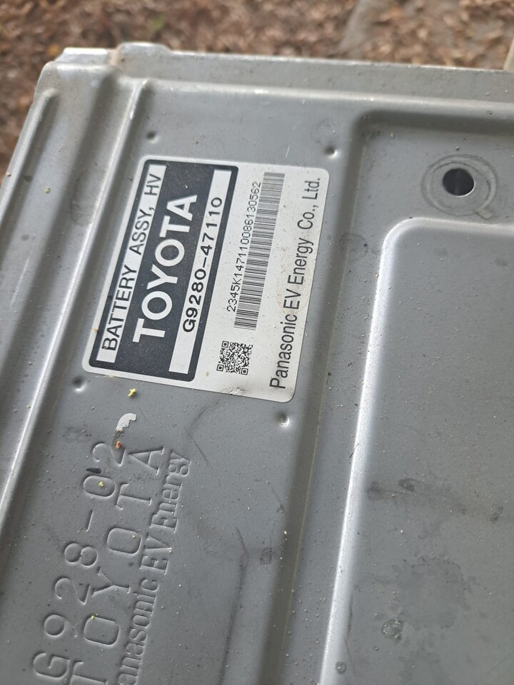

    Hi friends,
    My hybrid battery is dead
    (along the years I've replaced dome cells and balanced them by own).
    I've found someone that cells complete pack.
    I'm trying to understand if there is a way to know the manufacture date by the sheetmetal serial.
    At least to get some idea before validating on the cell itself.
    Any help will be appreciated.
    Attaching the serial image.

    Sells a complete pack of what refutbed modules . That won't have anything to do with the QR code or the sticker on that battery because what's inside case is no longer original .! Now if he saying their new then that code on label should have some mfg info I'd think. Original batteries to the cars didn't have QR or this info stamps on them . Later units did . And I thought mfgr date is contained in that info tag .

    There are MANY OEM HV batteries that are not 100% sequential and can even have date codes a day or two or even more apart. All that does is verify the battery modules are likely 100% original. It does nothing to verify condition of the modules. How does that have any impact on "lasting as long as possible"? The metal case serial number date code should be within about 3 months after the date code on the modules to account for supply chain assembly to assume it's the original case for those modules.

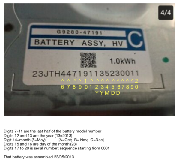

    No, I think it's more likely that battery case is #0562 assembled on 6/13/2008. So it's either a completely original 2008 battery or it's been rebuilt and had some modules replaced. Then the questions becomes whether the voltage sensor harness was replaced with new, what is the condition the ECU pins where the harness plugs in, and how well were the capacities of the 28 modules matched? It is VERY common for these pins to have corrosion and it's very common for original harnesses to be reused, even though they are typically corroded and likely to start providing intermittent voltage signals resulting in the battery throwing a code. A well matched set of 28 modules will perform much better than 28 randoms.
    Found this in an older thread to help you visualize. It's close enough: You'll notice the 5 digits directly prior to the YY is the last 5 of the battery model number.

    There you go that's the breakdown I was looking for the serial to year breakdown it's always embedded
