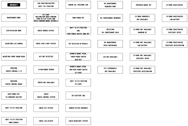

  4. ChapmanF
    28,725
    19,025
    Are you positive it said that, and not check hybrid system (third row, second column below)? There's a lot more to the hybrid system than just the battery.
