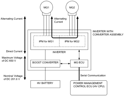

    "Booster" here probably refers to the boost converter, but we really ought to pause until we can see the exact code(s).
    Here's a block diagram from a gen 3 liftback, probably good enough for this post, though I don't remember if the c has a nominal battery voltage different from the liftback's 201.6 volts.
