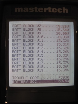

    Have you? Do you have techstream or a phone app like Torque or Hybrid Assistant, etc that allows real time monitoring of block voltages so you can see what the ECU is seeing?? Your 3030 code is not signalling a bad module. It's signalling a bad wire or connection. Connection would mean either end of the wire, Search P3030 and you'll probably find this online:
    [​IMG]P3030 translates to “High Voltage Line Snapped”. It sets whenever the HV Battery ECU detects an open circuit to one of the battery blocks. The Prius battery has bus bars that run down either side of the pack, to connect the modules in series; on one side of the battery it also runs “sensing wires” to each bus bar (effectively monitoring every two modules, which it calls a “block”). This is how the computer keeps track of total battery voltage (by summing the values of all the blocks) and the balance of those blocks.
    (Pic of “freeze frame”, a data snapshot, when P3030 set. Note the loss of voltage reading at block 10 (0.83v), but also that the car substitutes a max voltage value (20v) at the previous block, 9. I am not sure why this is the case, but it happens at whatever block is just before the one with the broken wire. I assume it has something to do with how the ECU calculates voltage from one block to the next, but it also makes sense that it would max another value to help compute total battery voltage.)
    ZeroDigit and SFO like this.
