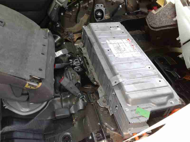

    Hi - I have a 2006 Prius T-Spirit, with 130,000 miles on the clock.
    A month ago I got the big red triangle (of death). Took it to a regular garage as I knew my front brakes needed fixing, and apparently sometimes if the brakes are down to the metal this can trigger the triangle warning as the brake fluid pump is having to work overtime... Anyway, they fixed my brakes, and kindly read the systems error codes -- a P3000 fault. Which the internet tells me is likely the hybrid battery.
    Anyhoo, happened to have the car booked in the Toyota garage for those recalls the following week, so waiting for then, got them to interpret the codes (sadly this extra cost me £50!!) and they essentialy told me exactly what I had told them - P3006 & 3007 - which they interpret as 2 cells in the hybrid battery have failed). They wanted £1500 to replace the whole hybrid battery (out of warranty due to high mileage).
    So, more googling. Some relevant youtube videos... I'm not allowed to link to them, but their youtube ids are jwy1tcVHJ_g and _UoSuKiqzd8
    I bought ONE replacement cell, likely from a scrapped Prius, for £25 on ebay. Plus a £4 multimeter from amazon. Even splashed out and bought a £4 tool for removing upholster clips (as in video 1) -- with hindsight this was a small waste of money (but after wasting £50 on getting Toyota to read the codes, why not...?). I already had a ratchet spanner set.
    After about 6 hours, all fixed. Turned the car on. Light and display screen screen came on, no engine! After panicking for a minute, went back and thumped that orange safety disconnect plug again (turns out you have to push it in, close/left up the big handle/level part, AND THEN the handle slips down slightly to close properly. Back in the drivers seat, and success! The random other orange warning lights gone, but still big red triangle. Took it for a spin around the block, then off the shops. Red triangle has now gone, EV mode works, all happy!
    So, can i add anything to the videos?
    1. You will have to remove the whole battery from the car to replace one cell. I had hoped to do this with the battery still in the car - but the screws that hold the cells are on the bottom of the battery pack.
    2. The cells are packed in tightly, you will have to remove all cells from the end in towards the one you want to replace. SO - just get on and dismantle the whole thing.
    3. Having removed all the screws from the sides of the battery, its much easier to test the voltage on each cell - i was getting poor contacts on some of the cells due to the corrosion on some of the nuts.
    4. (I had already figured this one out) The prius has a sensor connected to every other battery - so faults on 2 adjacent cells likely means only ONE cell is duff.
    5. I did wonder if you really need to remove the seats to take the battery out. I think its possible if you have a really long extender on your socket set - but you need to get the bolts at the bottom of the battery on the forward side. Maybe this possible?? i'm not sure.
    6. You don't need to do anything fancy to reset the codes - the system works out that the battery fault code isn't appearing anymore. Didn't do anything special, but did try to go through a whole charge and discharge cycle with my driving on the way to the shops.
    7. Wondering if I should stock up on a spare cell or 2 for next time?
    All in all a successful day. :)
    If anyone is reading this and deciding whether to give it a try or pay the money to Toyota... 1. I am not a mechanical engineer - and this was pretty easy, 2. Always remove the orange safety plug before attempting work on your battery, 3. Ask questions, if sure someone will answer!

    The others here who have successfully replaced traction battery cells have gone through very careful balancing to make sure all the modules are well matched. While I hope you are good to go for many miles, I wonder if you will end up after a while with a "whack-a-mole" situation, and another round of cell replacement. Please let us know how it goes.

    I have to say i don't understand this.
    So the "whack a mole" scenario may well come true - as my battery has done over 130K miles, chances are another cell may fail soon. However, with the whole charging / balancing thing... what do you mean? how does it work?
    Surely the prius is constantly discharging if i drive until EV mode is exhausted and then re-charging all the cells, so what would balancing do that the Prius's own system doesn't do?? (i am interested if someone can dumb it down for me)

    While the Prius battery ECU undoubtedly has some sort of cell balancing and equalization cycling that are used to keep the individual cells from diverging from the rest as they age, it is unknown (read "proprietary") to what extent it can handle a situation where one cell is quite different from the rest. That is why the safest course has been to make sure ahead of time to test all the cells, and to confirm that the individual modules are as close to each other as possible. It is a time consuming process.
    Here are some recent threads, following along in the advice of the battery engineers that contribute here:

    I applaud your fix it get up and go! As far as cell balancing, all packs age differently according to the individual driver. When you measure your good cells, they will read very close to the same voltage. Now if you put cells in from a low mileage pack into a high mileage pack the new cells may have more volts/amps than the high mileage cells. Thus an imbalance in the charge discharge cycle. It all depends on what the new cells are compared to what you already have! If it's not more that .25 volts, I would not worry about it, If I keep my car for that many miles, and have a battery, I would just replace as necessary! PIA, but it works!
