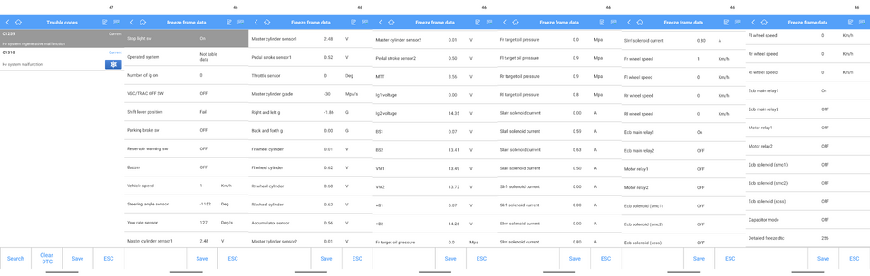

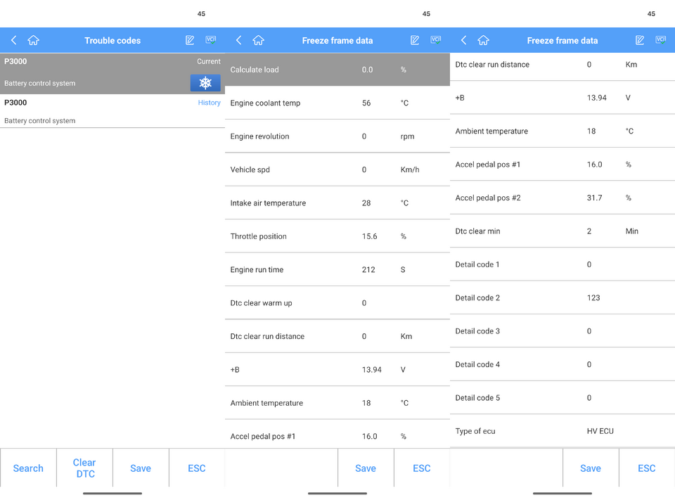

    I pulled the codes using an Autel AP200 giving:
    C1259
    C1310
    P0A80
    P3000
    P3021
    The freeze frames are attached. It shows block 11 at 14.85 V. Dr Prius confirms this block is running approximately 2 V low.

    The freeze frame data you posted would be from the P0A80 code, not from the C1310 code. Please post all the freeze frame data, not just some of the data.
    From the partial freeze frame data that posted, I agree that one or both of the hybrid battery modules that make up block #11 is/are bad.

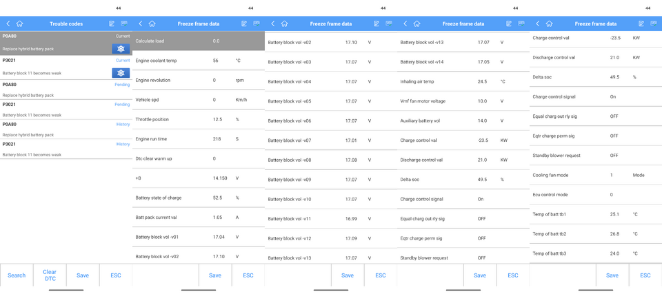

    Ah, thank you for having a look! I've added the freeze frames for all of the codes that have them. I also spotted a new P3021 code, so added that too.

    The P3021 freeze frame data shows a 6.44 amp current flow when the code occurred, which is quit low. The lowest battery block was #11 at 14.73V and the highest battery blocks were #13 & #14 at 16.28V. So, the voltage difference was 1.55V.
    Let us know what The Hybrid Geek says after they look at your car.
