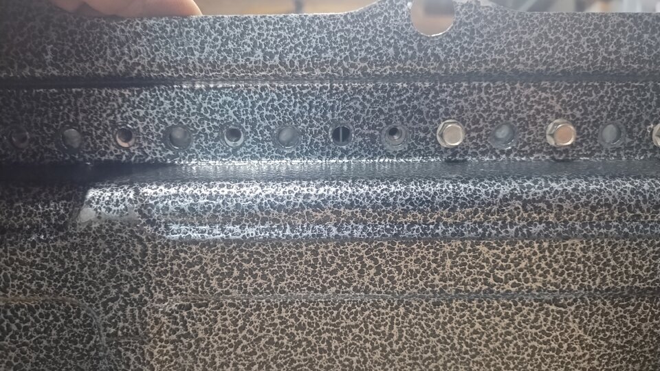

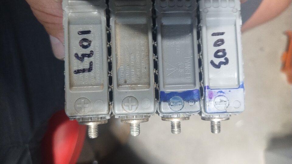

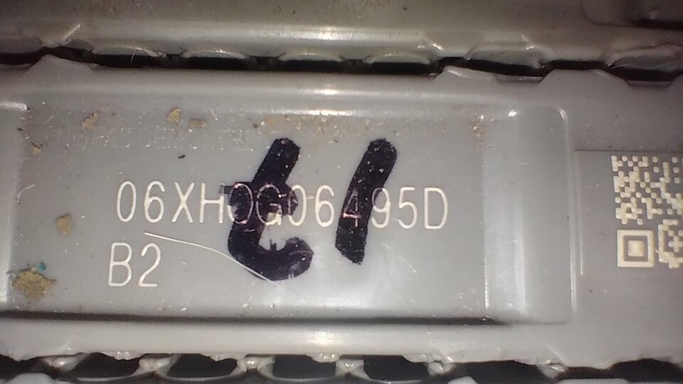

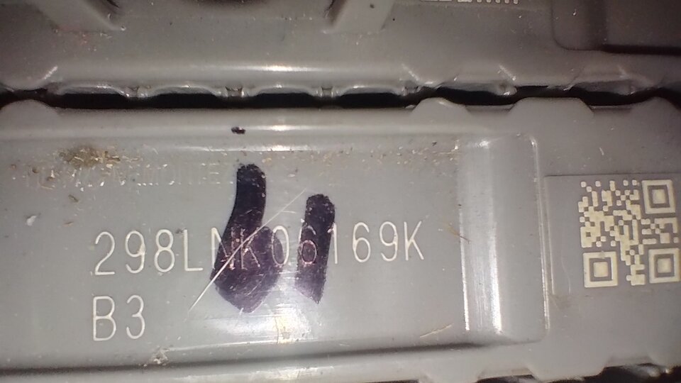

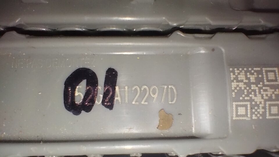

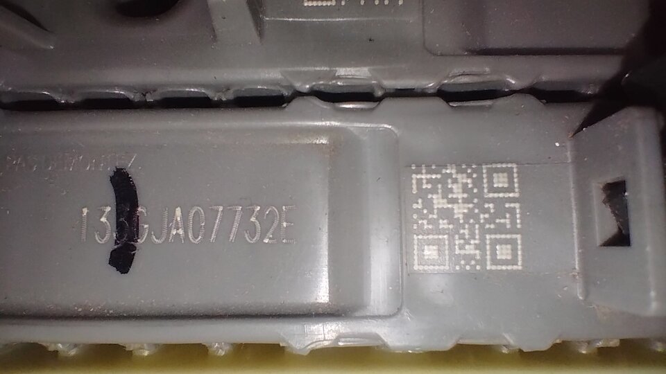

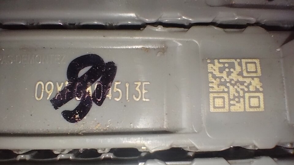

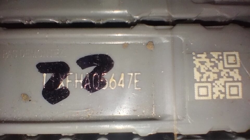

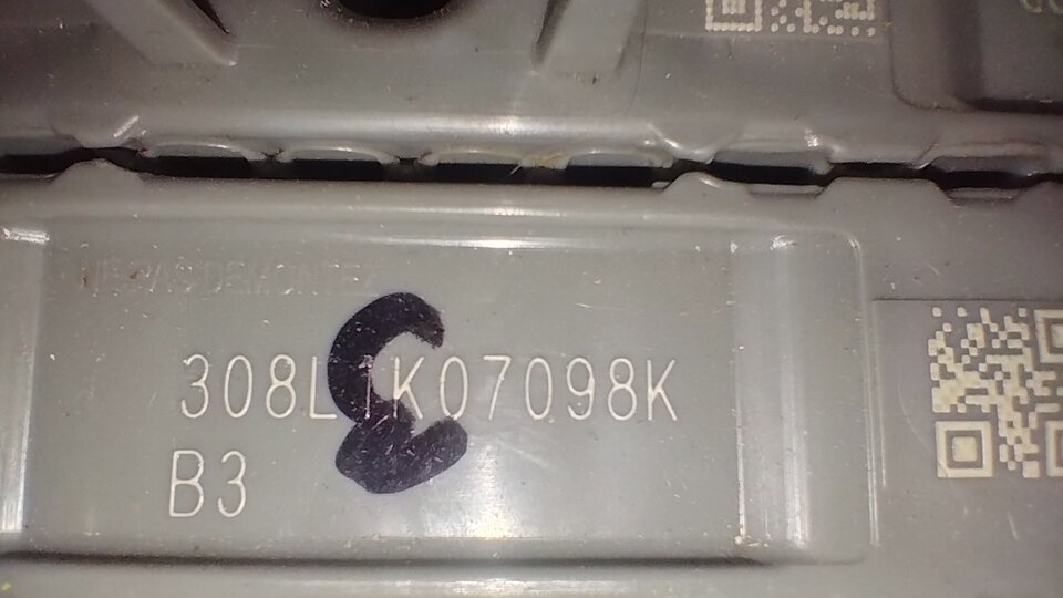

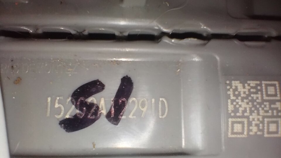

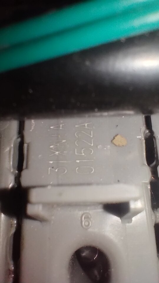

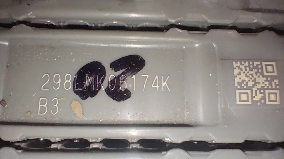

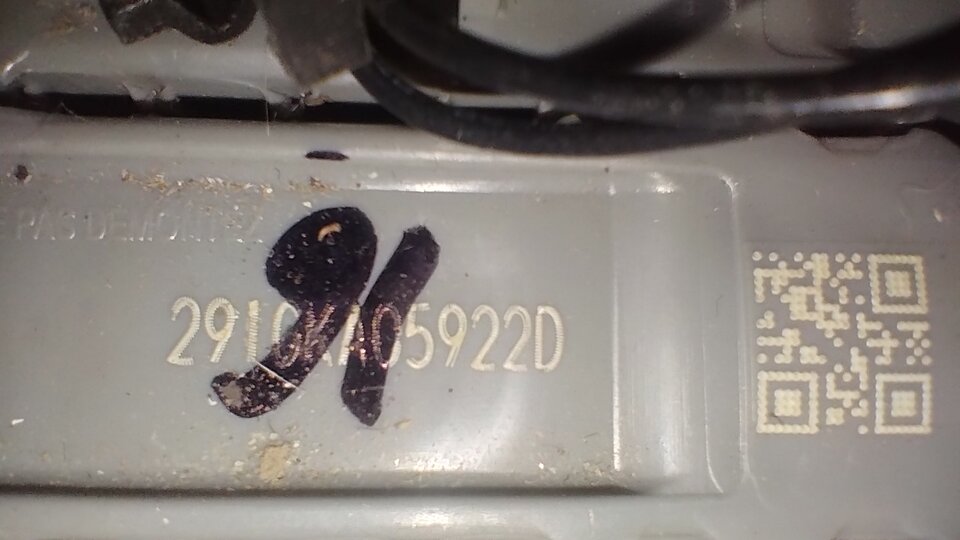

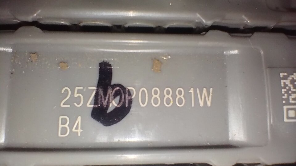

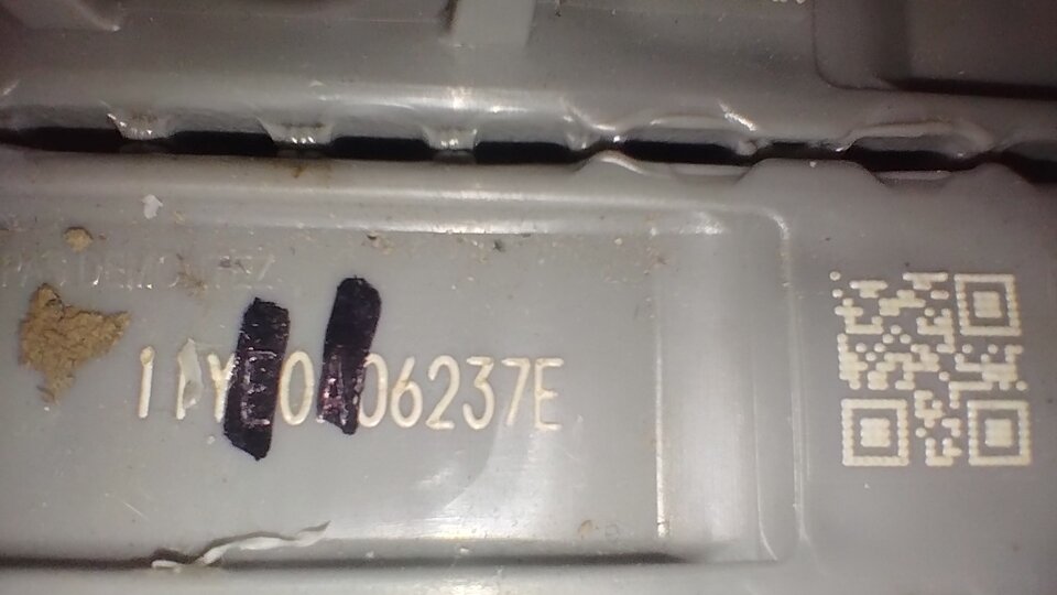

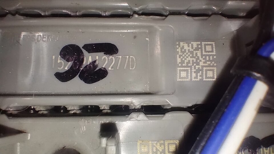

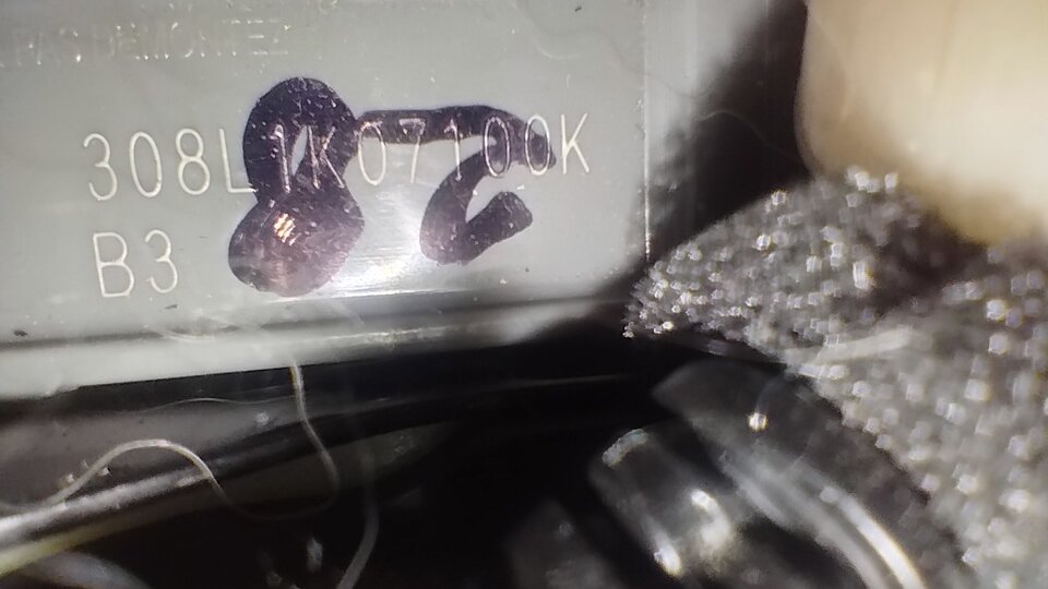

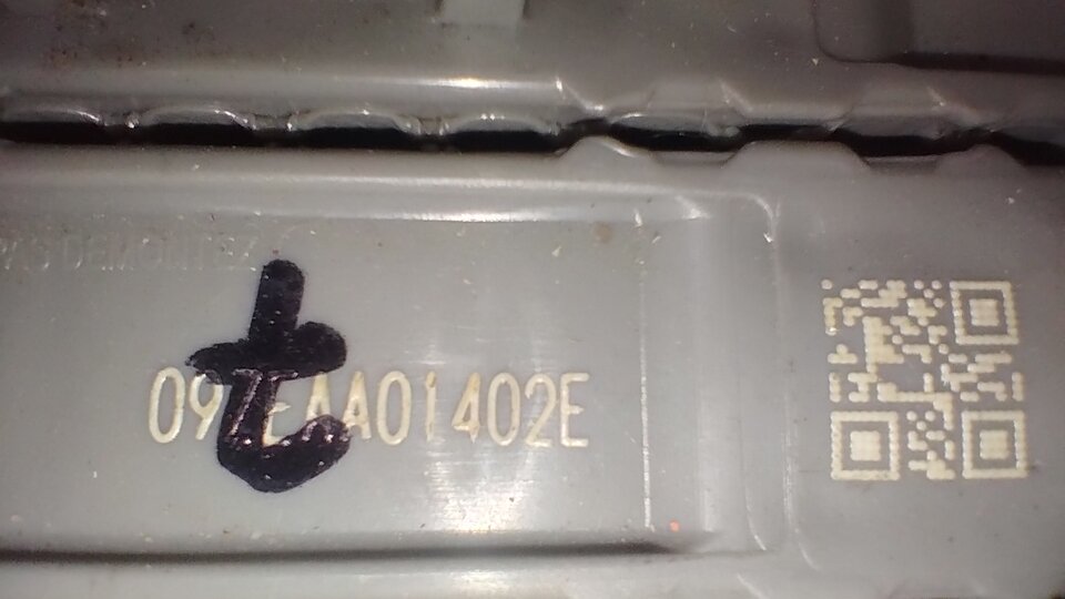

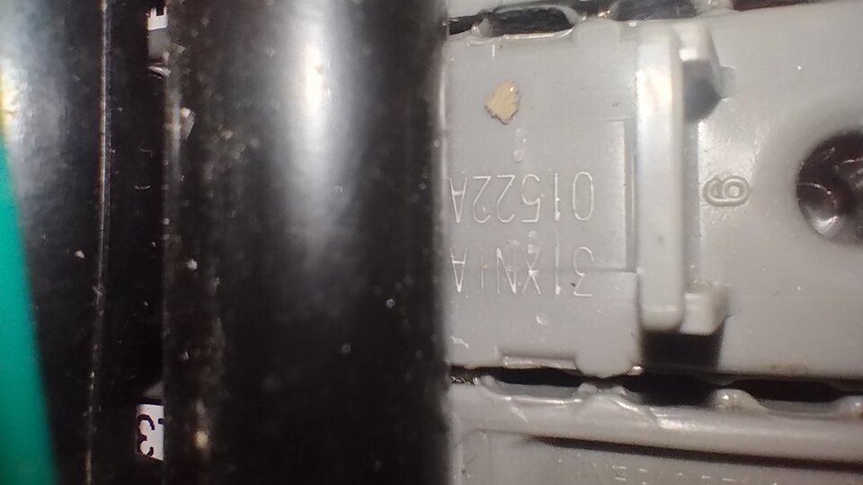

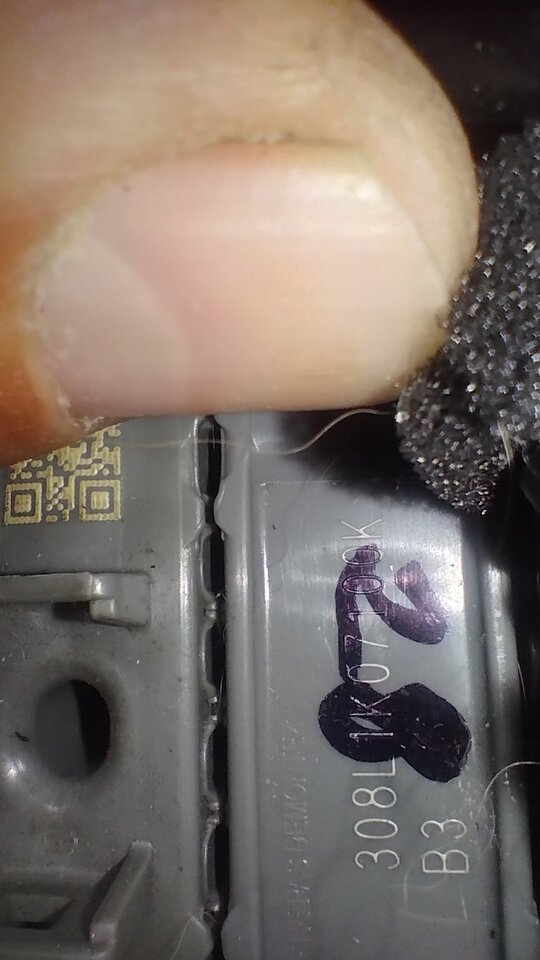

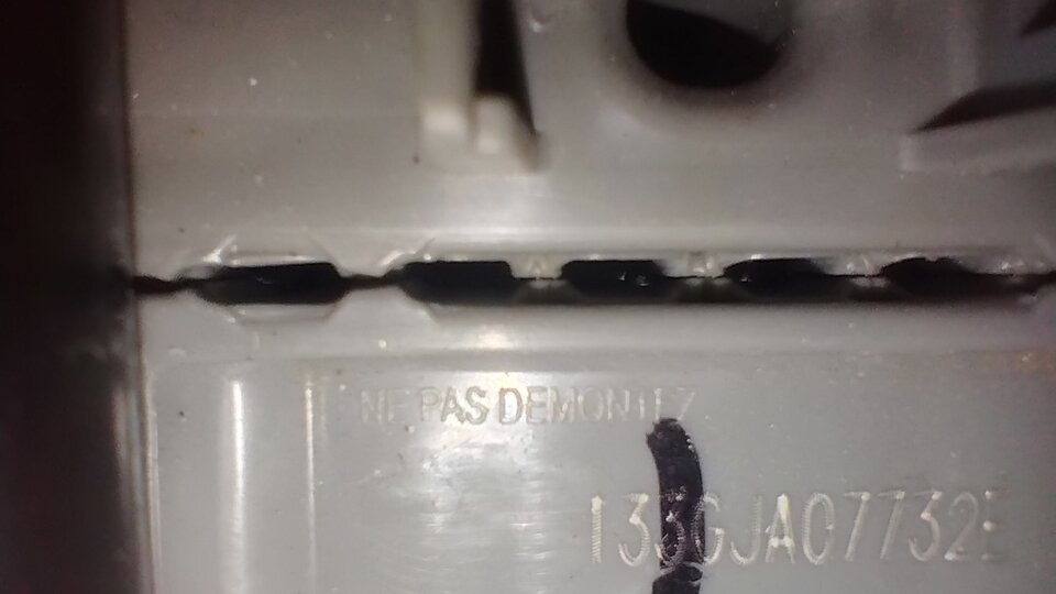

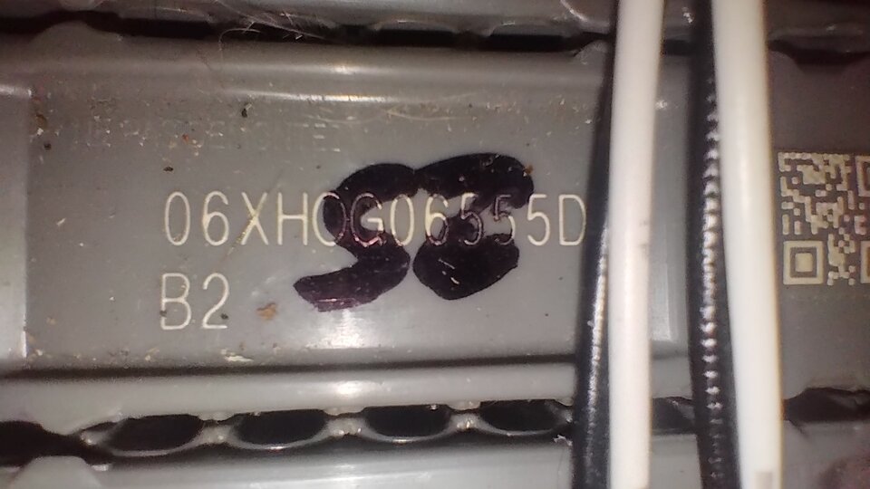

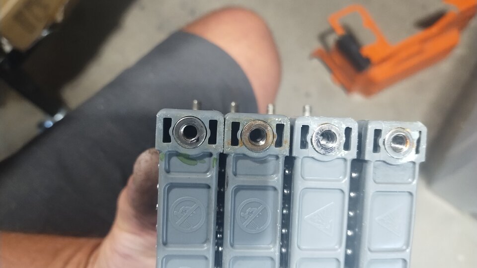

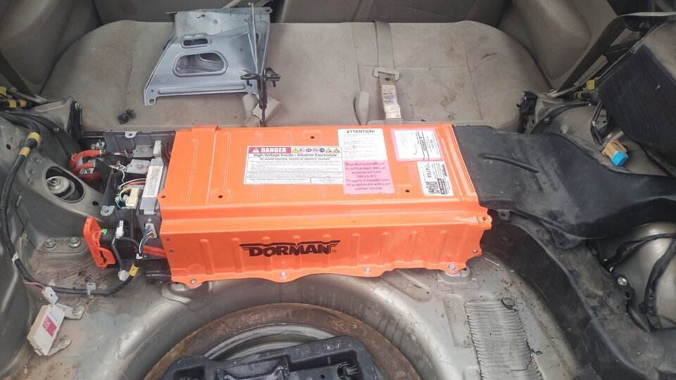

    so did the quick dirty swapped Toy 1/2 to replace Dor 13/14 will install in vehicle tomorrow and (fingers crossed)
    Interestingly the Toy and Dor have the bottom bolts on oposite polarities - Toy on + and Dor on -
    after putting on the final cover and flipping over to install bottom bolts at first I thought I put the cells in backwards so removed cover and , whew, I confirmed cells were in correctly but this different bolt anomaly .... and all the Toy cells are the saem and all the Dor cells are the same (to say on opposite side)
    (pics) IMG_20250728_220943295.jpg IMG_20250728_220937849.jpg IMG_20250728_220122687_HDR.jpg IMG_20250728_214502415.jpg

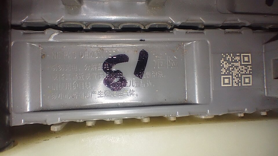

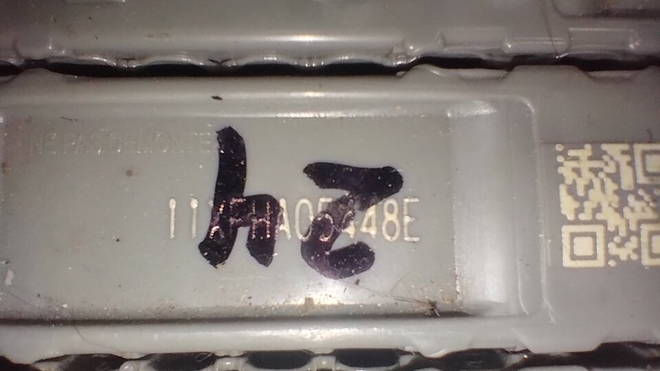

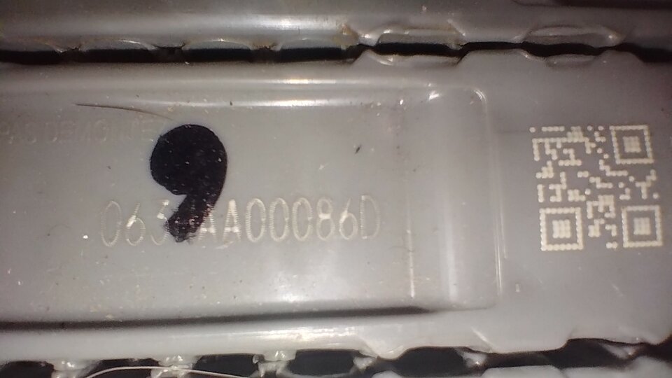

    Can you post the serial numbers of those modules? Photos? I've seen thousands of these modules and never had any with the threaded insert on the negative side. The Gen 1 has them on both sides, but I've never seen (-). I've heard of these modules being used in applications other than automobile HV batteries. I wonder if these (-) term inserts are from one of those alternate uses? Maybe a sly way of IDing them. I know Dorman has used Gen 1 modules in some of their Gen 2 rebuilds, so it wouldn't be a total surprise if they had alternate sources of modules.

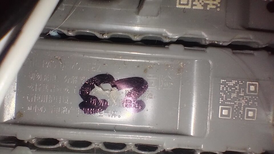

    I can post photos tomorrow of the top of the cells. As far as serial numbers, please specify which/where are the SNs so I can transcribe them into text in my reply.

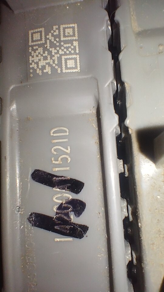

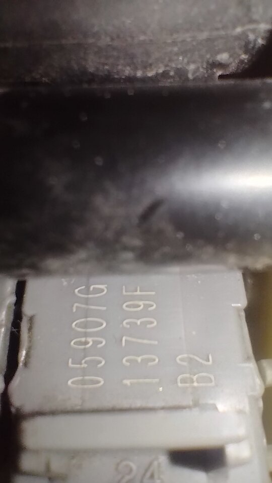

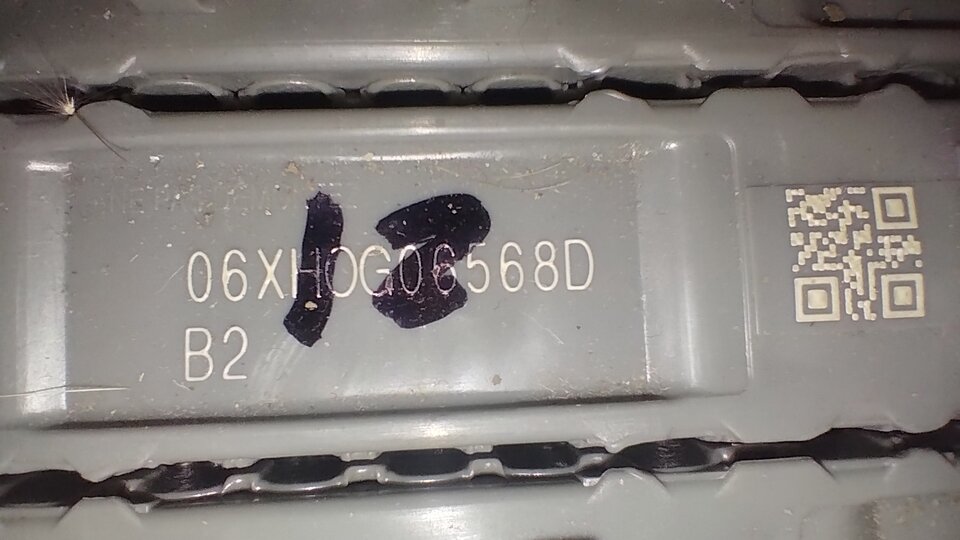

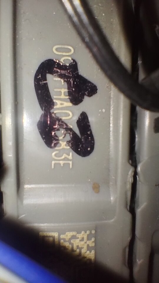

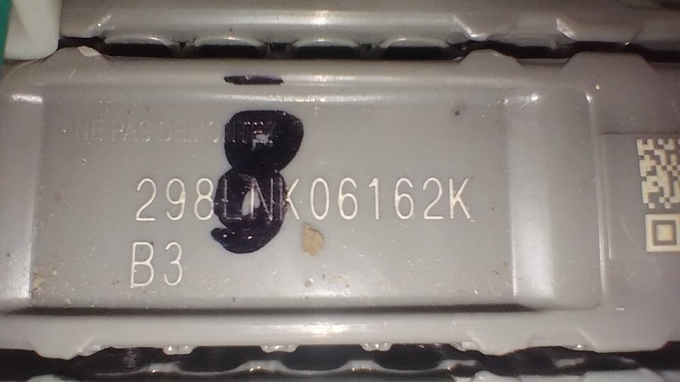

    Thanks!! This has really caught my interest! They are directly on top of the modules. Typically near the center, newer gens have the serial number positioned where it would be under the black metal bars on top. Just to make it more fun to read I guess.
    It should be white lettering, but sometimes they're a bit faded. Most cell phone cameras can make even the most faded numbers show up if you find the right angle.

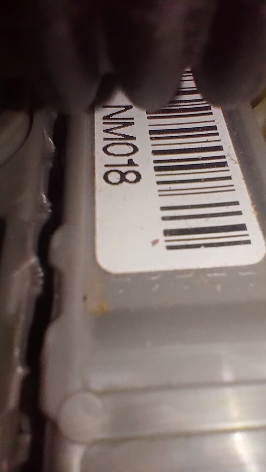

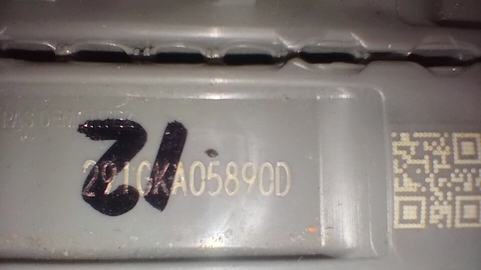

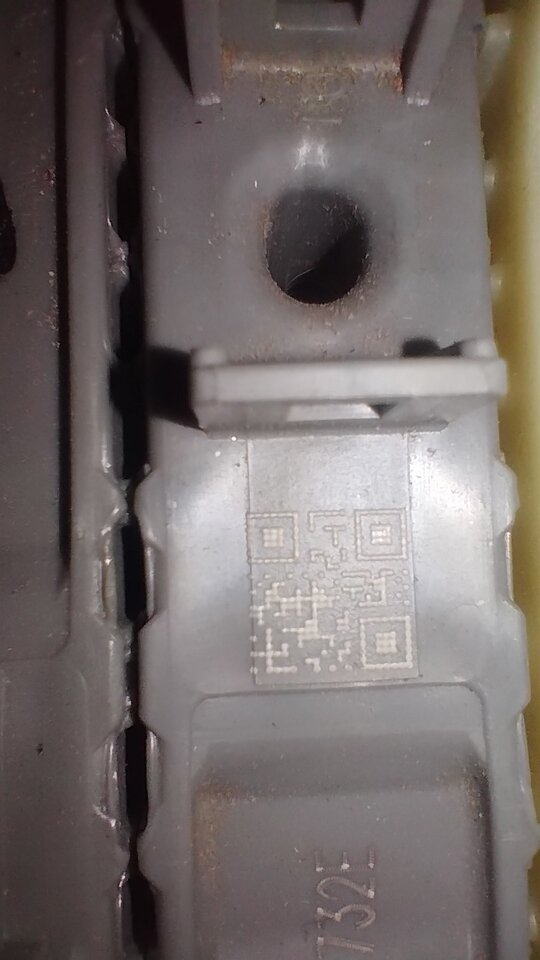

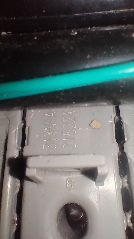

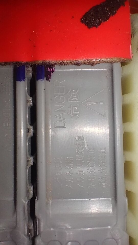

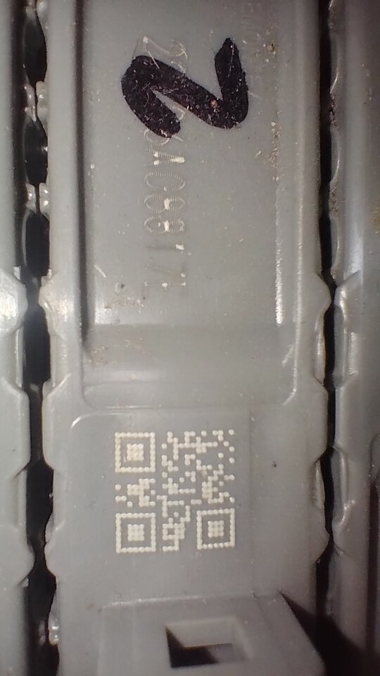

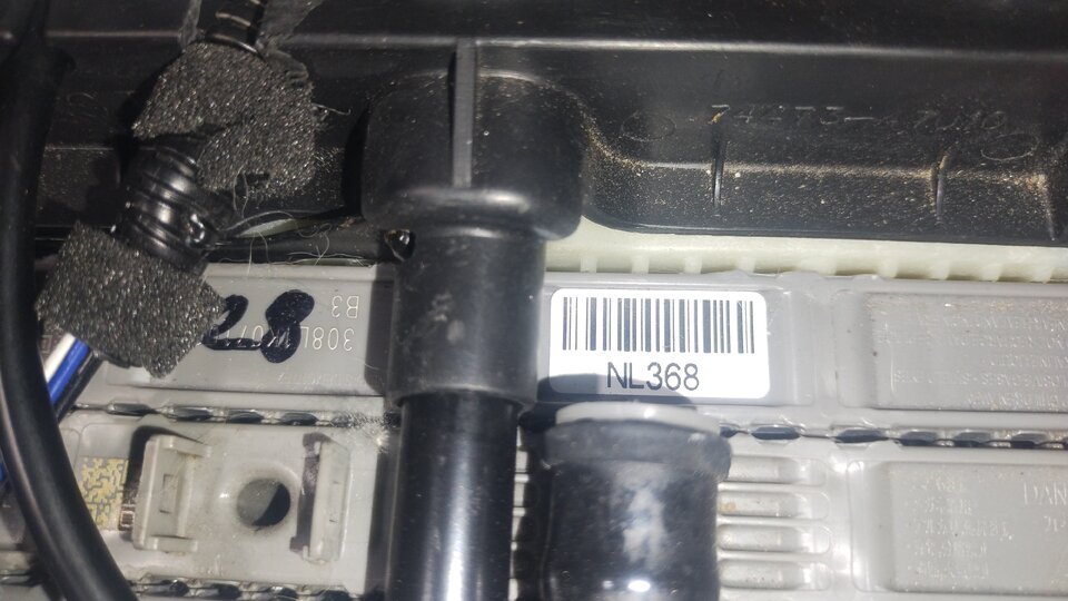

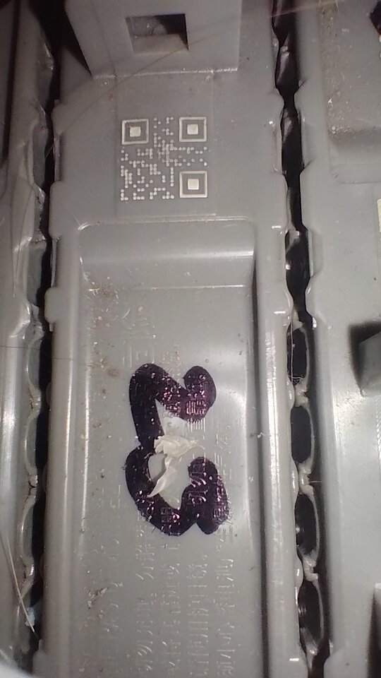

    re: serial numbers on the DOR pack (with the bolt holes on the - terminal side
    1) images attaching. I might transcribe off these pics when I have time. if anyone transcribes before then, please post the SN characters so folks can research off of them
    2) interestingly, there were 2 cells that were the "newer" type that had the SN under the black bars.

    installed cells 1/2 from Toy into position 13/14 Dor. car runs.
    on initial start up Dr Prius app gave it:
    life expectancy test of - a 55.42% "fair" report
    full battery test - all good except for poor balance on blocks 4,11,12
    ...will see how it does as it goes along.

    This is typical of a refurbished pack from "professionals", considered a Frankenstein pack. I wouldn't keep your hopes up on this lasting long. They would be severely out of balance with the different years and capacities, all bundled together.
    From the few that I saw, It looks like you have modules from the 1st generation all the way up to the 3rd generation. This is pretty crazy.
    I think it's best you start off fresh, these are probably recyclable cores at best. Search for a used battery at wrecking yards, possibly from a later model Rav4. Those can be had for a few hundred bucks plus shipping. And it'll be reliable for many years to come.

    that's interesting - since they are all from the Dor pack and all have the lower bolt attachment on the negative side which seems rare for Toy cells.

    took it out for a 60 mi run. about 1/3 city speeds, 1/3 40-60, 1/3 70-85
    averaged 42.3 mpg which is better than my other Prius which has a 1yo/20k mi? new Toyota battery. that one gets 37-41mpg
    about half way though, the Dr Prius full test showed "Poor balance on Bank 5" which is different than the full test after initial installation. I didn't test it when I got home.
    Bank 7 (which has the replaced 13/14 cells) seemed to consistently be the lowest voltage bank but did not throw any codes.
    about 40mi into this 60mi trip the P0420 Catalytic code appeared. no other codes (yet)
