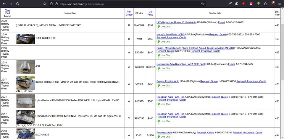

    2007 battery with almost 200k miles is most likely dead, dried out. The modules will fail one by one until eventually all 28 modules are replaced.
    I would buy a used Corolla battery from a junk yard and restore the capacity using the Hybrid automotive method before using the modules.
