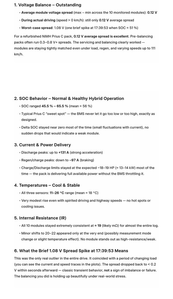

    Perhaps better than just using Dr Prius to get an error code - might be to use Dr Prius to record a log file as you do a nice long drive.
    On varied roads, up and down hills and at slow an high speed. Then email yourself the resulting log which you can easily upload as a file to an AI - I've used both Grok and chatGPT - which will give you a detailed, and expert report on the condition of the pack and any problems it may have. As a relative novice at this sort of thing, I found this very useful and very educational!
    Even if you are not in a position to service the pack yourself, it should give you enough insight to judge whether or not to believe a diagnosis you may subsequently get from a 'pro' ? Also, try uploading to more than one AI, as they vary in the style of their reports and one might be better or more easiiy interpreted than another! A print-out might also be a good guide for anyone who does look at the pack for you.
    pasta4breakfast and Tipjar like this.

    Wow, thanks for the suggestion. Interesting reading that Grok summary.

    Got to be kidding...
