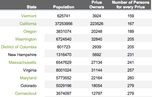

    Good data. Sounded low at first since VA now has 92000 hybrids/plug-ins (80% of these in NoVA) but if you are saying Prius Liftback I guess it might be good. Experian 2012 data shows Prius liftback around 38% of market with Prius c, v, and TCH each about 8-9%.
