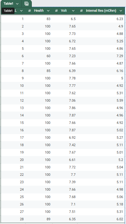

    Hello, I'm looking for some help diagnosing the Red Triangle of Death on my 2005 Prius. The triangle came on a few weeks ago, and since then I’ve noticed a loss of acceleration power and the fan running loudly in the back. I tried running a test with Dr. Prius, but it wouldn’t complete because the battery was too cold or something. I decided to open up the battery pack and test all the cells individually, following the instructions in a video using a Harbor Freight battery tester. I recorded the results in a spreadsheet, and I’m not seeing anything that looks particularly bad, but maybe I’m interpreting it incorrectly. The lowest health status was 60%, and most were 85% to 100%. None of the internal resistances looked too high either. Would that be enough to trigger the triangle and cause these issues? My other thought is that the green corrosion on the bus bars might be causing problems, or maybe it’s a bad inverter cooling pump or dirty fan.
    thanks!!
    CELL, Health, Volt, Internal Res (mOhm)
    1 83 6.5 6.23
    2 100 7.65 4.9
    3 100 7.73 4.88
    4 100 6.72 5.25
    5 100 7.65 4.86
    6 60 7.23 7.29
    7 100 7.66 4.87
    8 85 6.39 6.16
    9 100 7.78 5
    10 100 7.77 4.92
    11 100 7.62 5.31
    12 100 7.06 5.59
    13 100 7.86 4.96
    14 100 7.87 4.96
    15 100 7.66 4.92
    16 100 7.87 5.02
    17 100 6.92 5.27
    18 100 7.42 5.11
    19 100 7.67 5.01
    20 100 6.61 5.2
    21 100 7.72 5.04
    22 100 7.7 5.11
    23 100 7.39 5.11
    24 100 7.66 4.98
    25 100 7.68 5.06
    26 100 7.1 5.18
    27 100 7.51 5.31
    28 89 6.35 6.02

    The voltages of the 28 modules are all over the place. A static reading of healthy battery modules should not vary by more than 0.10 volts of each other. My guess is that the trouble code that occurred was P0A80 " Replace Hybrid Battery Pack".

    That's common if a failed battery pack sits for a while. As in this these numbers may be just self discharge data. As in modules that have self-discharged the most should be noted on the spread sheet to further the pack diagnosis. There's a dozen additional types of data points for evaluating a module/pack you can read about on PriusChat.
    Resting voltage isn't as good of a data point compared to module voltage loss after 2 minutes under load from a 50w/12v bulb.
    But this is just preliminary data... I'd like to see a charge and balance of the pack as well as a couple of deep cycling of the pack before drawing any conclusions beyond the replacement of failed or hot-running cells.
    All this and more is how you'll find the bad modules before they find you.

    Yes, your voltages are all over the place. Yes, any module that is under ~7.2v is bad and anything that has drifted down to ~7.4ish will likely be bad very shortly. A module that can be salvaged and become reliable does not drop below 7.2 volts for months and very good ones will stay 7.6 or better for several months. All the ones in the 6's? Toss 'em. They will never be worth putting back in your car. The others that are less than 7.4 may or may not be salvageable, but with the number that you need to replace, it's not worth the risk.

    I had watched two videos of people using the Viking 12V digital battery tester from Harbor Freight to evaluate these cells and use the state of health and internal resistance to determine which ones to replace. After doing this, I made the table I uploaded here and ended up replacing cells 1, 6, 8, and 28, as those were the ones that looked worst to me. I have since put it back in the car. Initially, it did not work, but I realized that it was because I didn’t have the safety lever pushed down correctly, which gave code P0A0D. I fixed that and cleared the code and tried to start a drive, but soon after, code P3000 came on. I tried clearing that, but it comes right back on.
    The monitor shows the internal resistances are much better, which is good, but I’m not sure if it’s struggling because the voltages are low from sitting for around 1.5–2 months at this point. Another thing that could be part of it is I didn’t put everything fully back together. I connected all the wires, the blower, the vent tubes, and the main top cover, but I skipped the two left-side covers/brackets because I didn’t know if I would be pulling the battery out or taking the covers off soon to test things. Do these have to be connected for proper grounding, or is it okay for me to leave them off for initial testing?
    I'm sure my battery testing would have been more useful if i had done it soon after i stopped driving the car. but now i cant get the car to recharge the batteries because its disabling the hybrid battery. What's the best next step for me? I really do appreciate you all taking the time to consider my issues and dealing with my ignorance
