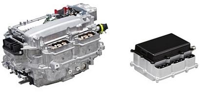

    Toyota has developed an SiC power semiconductor for use in hybrid vehicle (HV) power control units (PCUs). The company hopes the device (shown below) will improve HV fuel efficiency by 10% and reduce PCU size. PCUs contain an inverter and voltage converter and account for about 25% of HV electrical power loss -- most of it associated with the power semiconductors.
    Toyota developed the SiC device in house to ensure that it met automotive requirements. The company expects to begin test driving vehicles with PCUs containing the device within a year.
    Hybrid vehicle PCUs fitted with SiC power semiconductors (right) are expected to be much smaller than those using
    traditional silicon power semiconductors (left).
    (Source: Toyota)
