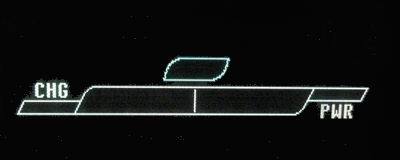

    I wander if by having the HSI on the HUD while simultaneously displaying the Energy Monitor on the instrument display help clear up some of the 2010 mysteries.
    Test drove a 2010 with HUD & found by having the HSI on the HUD is far more useful in when comes to all these P&G or hypermilling tricks.

    You haven't listed your location, so I don't know whether you're in Europe. In the U.S. we don't have a heads up display (HUD), so you are limited to the one display available at a time on the multi-information display (MID) located high on the dash, adjacent to the speedometer.
    I'd be very glad to have the HSI and the old energy monitor going at the same time, but it just won't happen. The HSI gives some interesting information, but 2,600 miles still hasn't been enough for me to really get the best handle on it.

    Back to the HSI, thingy, I did notice by keeping the HSI empty (meaning no bars indication), no arrows were observed on the EM (Energy Monitor). I could be seeing things as I glanced between the HUD and the dash display in those moments. Let me reconfirm again after another test drive. :D

    There's a good correlation, yes. I managed to get glide today on a test drive. I couldn't do that back in March in L.A.

    Came across a reference to HSI in a March post-embargo review with the author saying:
    "This indicator allows the driver to visually anticipate the threshold between EV and internal combustion use..... the HSI gives drivers the ability to accurately determine limitations moment by moment. This is an extremely useful feature sure to be very popular with owners."
    Since was "Chief" present, I guess it pretty much describe its main purpose and how it might be used in glide.

    most of the time, that be correct. but again, still depends on the mode. in EVO mode, you can get past the centerline without engaging engine.
    in economy mode it works, if going fast enough or SOC is low enough. (as the SOC goes up, the speed to keep engine on also goes up making it difficult to force the engine to run at lower speeds)
    its always been a given that running in EV mode was not good for mileage because of conversion losses, etc. but on the 2010, at street speeds, its hard to avoid. after you hit 6 bars, you literally have to be going 45+ mph... trying to hit stealth i found that its not as intuitive as it is in the SPM.
    usually on the SPM, i would frequently see mpg in the 120 to 180 mile range so that is what i am basing where i need to be on the 2010 and while doing this the HSI is literally all over the place so i am beginning to think the HSI is showing us what the classics were not designed to show and that is the transitions from "full EV, no ICE" to high mileage stealth with is "a little EV along with a little ICE"

    it seems you don't watch the HSI by referring to the arrow actions. do you use HSI at all? it seems easier to use.

    i use the HSI nearly all the time. i feel that it gives me a better idea of what the car is doing. but more importantly, it shows me the boundaries. i can see how much i have to push to turn on the ICE (past the center point in Eco or Pwr) which is better than what the classics provided us.
