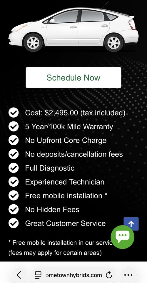

    Hometown Hybrids has a Houston, Austin and San Antonio shop. If you are in Gatesville, Tx their Austin shop would be closest or use their free mobile service.
    $2495 new installed that will last 15 years
    $1195 "rebuilt" with 2 year warranty
    2004-2009 Toyota Prius New Battery

    $2500 for an OEM battery installed is a fantastic price. Almost too fantastic. Their site says they are using Toyota OEM batteries (I checked, because some other businesses just say "New", and those are not OEM modules), so they must have worked out a significant bulk discount with Toyota. This must not make them very popular with the surrounding dealers' service departments, since those would likely be charging around $4000, and only warranty for 3 years instead of 5.

    I used them years ago. They are legit and buy a lot of batteries from Toyota.
