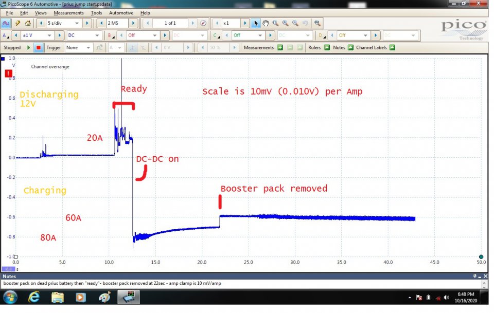

    When mr_guy_mann did that for a gen 2, it looked like this:
    The only time it gets anywhere near 100 A is one instantaneous spike during the time bouncing mostly around 20 A. (The kinds of things that often produce an instant spike like that also often work just fine if the power source slightly limits the height of the spike.)

    Gen 2's are much different than Gen5's as best I can tell. I'd like to see the data for Gen5 12v battery current discharge from OFF to READY mode.

    I was sure that was why you asked, and I was confirming it's a reasonable thing to ask.
    We have those graphs for gen 2 because people asked, and then went and did it.

    And lots of 30-A spikes, quite-a-few 50-A spikes, in addition to the 100-A spike.
    Moreover, Gen 5's electronics are probably more demanding and draw even a higher current.
    This is why a degraded 12-V battery with a high internal resistance won't be able to start the Prius, as the battery voltage will drop too much during the high-current peaks.

    Why would anyone with common sense do that? It's obvious using a booster pack that very little current is required to put the car into Ready mode. The battery clips would overheat and melt if anywhere near 100 amps were being drawn.
    The burden of proof is whomever made the claim that 100 amps are required to put the car into Ready mode.

    I looked at the battery monitor record. It appears the start up voltage, on the start up battery, drops from 12.6-12.7 v to 12.1-12.2 v in my example period. So .5 v appx. Whatever that means to the amps drawn. This is before the dc converter kicks in.
