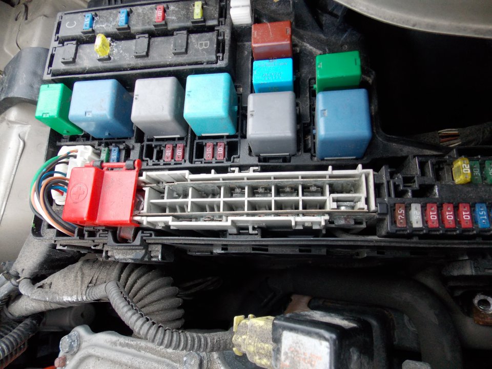

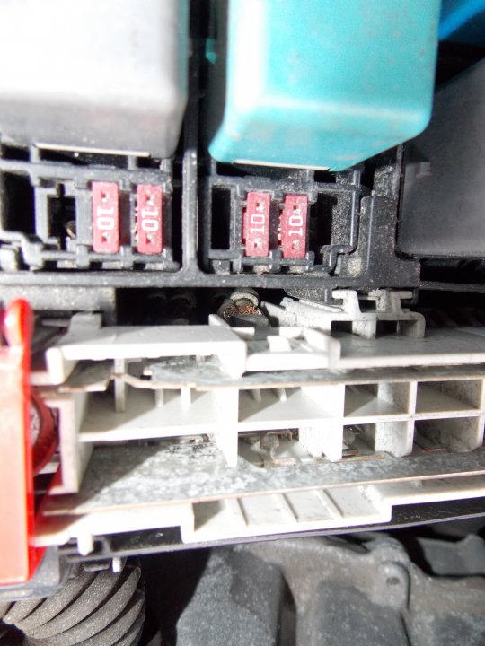

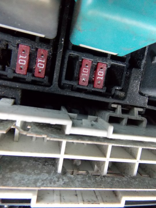

    Hi all. I've taken a few photos of the fuse box(see attached files) and my initial impression is that I don't think there is that much corrosion. With that said, I can't really see too much of it with all the plastic fittings. That's why I was trying to detach it (which by the way proved a little to difficult/involved to accomplish), so that I could see underneath where all the wires connect in. But since I couldn't do that, I took an overall photo of the box and a few close ups of the exposed metal of the big fuse. You can take a look, and please let me know if there are other specific photos I could take that would be helpful for you to understand things better.
    As I mentioned, my overall conclusion is that I naively don't see what seems like a big corrosion problem. At the end of the day, the one definitive thing they found when they checked it out at the dealer was that the fan cooling the hybrid battery was not getting power. And they traced the lack of power up to the front fuse box. I don't know exactly how they got to the conclusion that it was corrosion in the fuse box that caused the lack of power.
    My next plan is to look up which fuse relates to the hybrid battery fan and try to check out that fuse specifically and see if i can get to the connectors on the bottom and find out if there is any corrosion and anything obvious I can do about it.
    ericbecky, do you make anything of these pictures? Thanks for offering a lead on someone who might be able to help. I'd like to see what I can do on my own, but if worse comes to worse and I just can't manage anything, it sounds like that guy might be worth checking out. It'd be quite a trip for me, because I can't drive it all at once in the prius without concern of the batter overheating without it's fan, but not out of the question.
    Thanks again everyone for your help. My wife and I are really in a pickle here and are pretty dependent on getting this car working. We just bought it used in the past year and don't have much money for repair and definitely not for a new car. So, you guys are quite the godsend if I can end up repairing this myself or cheaply. Ah the grad student life! Thanks for your time and energy!

    1. You need to replace the fusible link. That part provides substantial power to several circuits and lives in the ~5" long whitish box. That box is supposed to have a clear plastic cover. Since it does not, your photos show some pretty nasty corrosion within. The link that I earlier provided in post #32 explains how one member did that replacement, which is not going to be an easy task.
    2. If you are not going to replace the relay/fuse box, you at least need to get a suitable cover for the existing box to prevent further corrosion damage. Contact autobeyours.com to see if that vendor can sell you a relay/fuse box cover.
    3. I suggest that you need to remove each fuse and relay in the relay/fuse box, one at a time, to inspect the socket below each part. Use electrical contact spray cleaner to clean off any corrosion that you find. Use an ohmmeter to measure continuity of each fuse before replacing it.
    4. Regarding the traction battery fan, that receives power from the 10A BATT FAN fuse and the Battery Fan Relay. The fan speed is controlled by the battery blower motor controller and the traction battery ECU.
    5. You need to obtain Mini VCI (which runs on a Windows XP or Windows 7, 32 bit OS laptop) because that will allow you to retrieve DTC that your car has logged. Since five DTC were reported by your dealer, you should not expect that your car only has one problem. You'll also need to subscribe to techinfo.toyota.com to obtain access to the factory repair manual and electrical wiring diagram for your model year. This will help you to interpret the logged DTC and figure out what to do about them.
    6. I hope you didn't pay much for this used Prius when you bought it last year, because electrical problems can be very difficult and costly to find and repair. Good luck.
