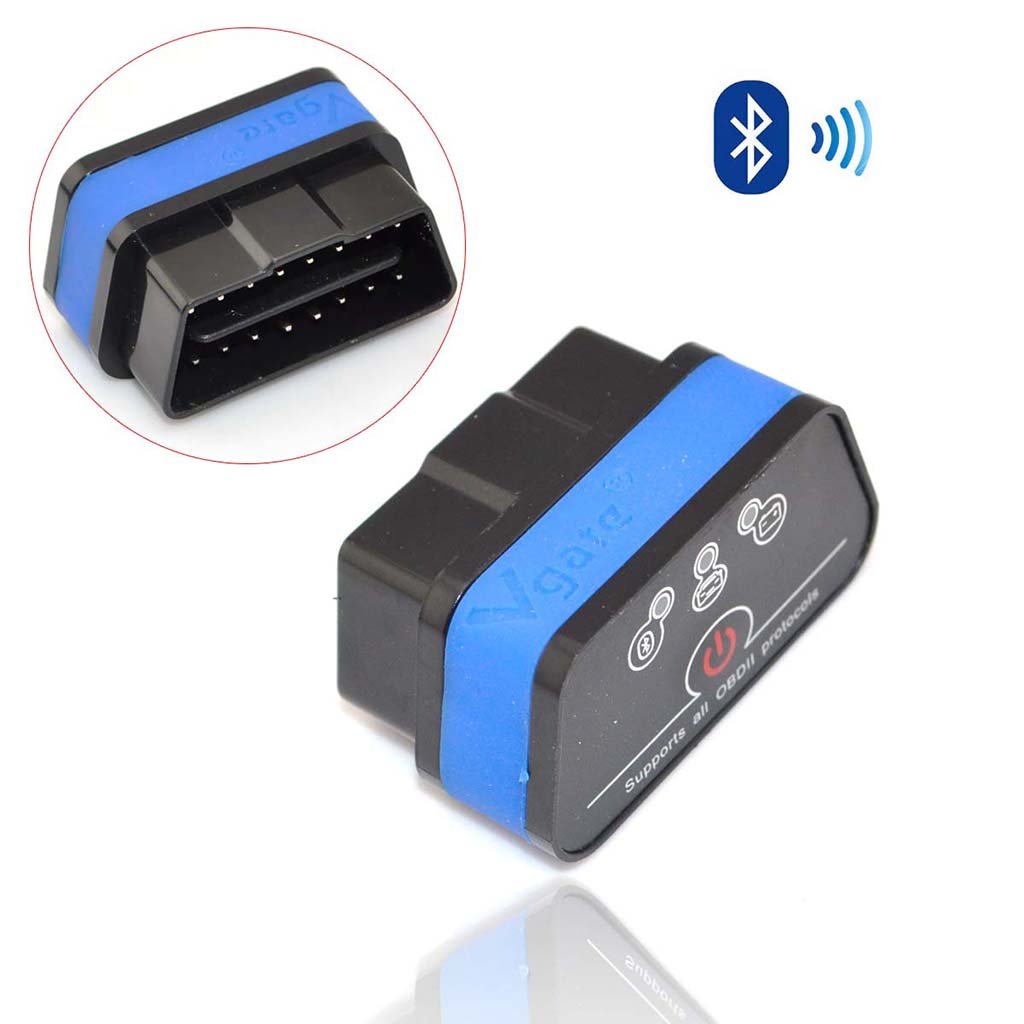

    I've got the following iKKEGOL iCar 2 Mini OBD2 II Bluetooth Car Diagnostic Scanner:
    iCar 2 scantool is a high-quality automotive scanning tool, supports all OBD-II protocols :
    0.Automatic
    1.SAE J1850 PWM(41.6Kbaud)
    2.SAE J1850 VPW(10.4Kbaud)
    3.ISO9141-2(5 baud init,10.4Kbaud)
    4.ISO14230-4 KWP(5 baud init,10.4 Kbaud)
    5.ISO14230-4 KWP(fast init,10.4 Kbaud)
    6.ISO15765-4 CAN(11bit ID,500 Kbaud)
    7.ISO15765-4 CAN(29bit ID,500 Kbaud)
    8.ISO15765-4 CAN(11bit ID,250 Kbaud)
    9.ISO15765-4 CAN(29bit ID,250 Kbaud)
    A.SAE J1939 CAN(29bit ID,250*Kbaud)
    B.USER1 CAN(11*bit ID,125*Kbaud)
    C.USER2 CAN(11*bit ID,50*kbaud)
    Default settings(user adjustable)
    but HybridAssistant does not work with it for the reasons beyond my understanding.
    Am I doing something wrong?
    Please note that this adapter does work with Carista and Torque.
