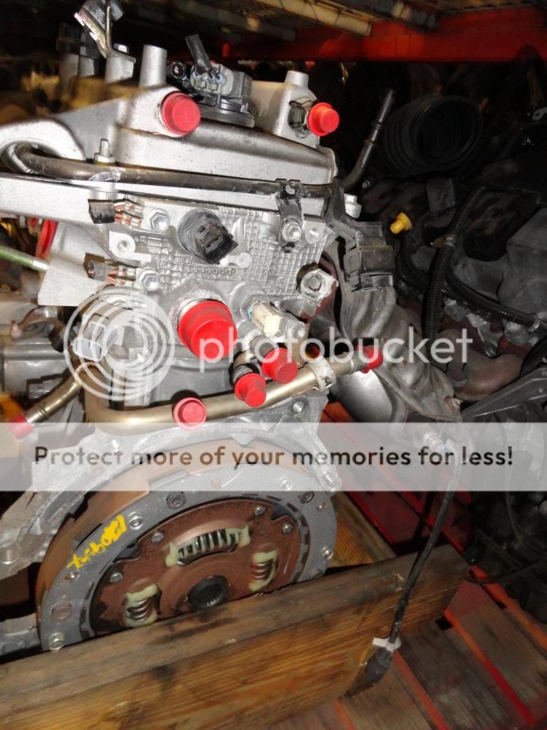

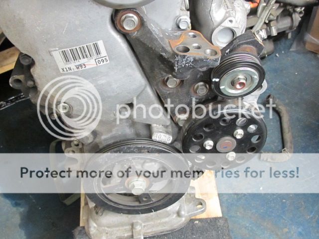

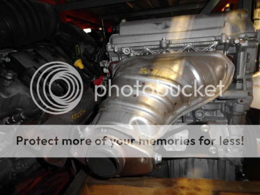

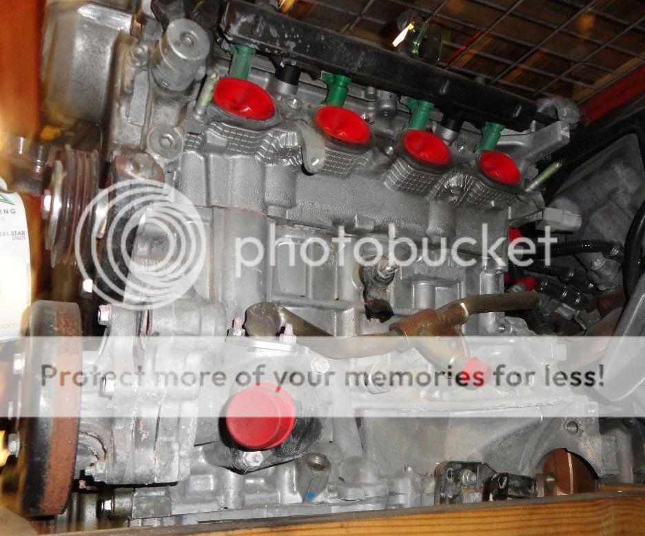

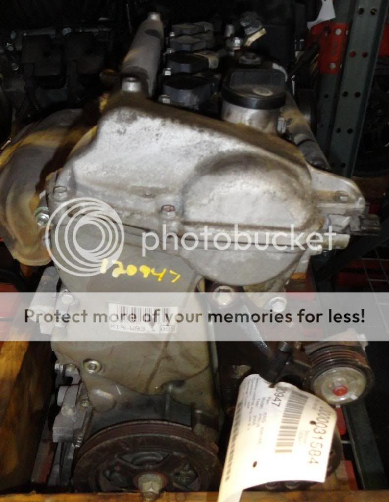

    ***** I have some pics of a potential replacement engine ... this 2005 salvage car (same year) was impacted from the front left (where most of the engine is closest) .. so a broke bracket and pipe in the front ... but .. otherwise would appreciate your feedback on it .. thx ..
    [​IMG][/IMG][​IMG]

    here you can see a broken bracket (down by flywheel ) and chinked out piece of pulley on right (which will require both being pulled from hydro-locked motor)[​IMG]

    here is the very nice looking (pretty bright red tube covers- which I hope were put on immediately the day it was pulled) flywheel (back-side) of engine .. it is humid in florida and no doubt this shop is not air conditioned or even de-humidified, evidenced by the layer of rust on flywheel

    intake side (removed - i'm sure it got crushed somewhat) - notice pipe that is mangled and crushed a bit ..

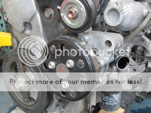

    Here's photos of a "good" engine. The brackets on the exhaust side are not needed. The water pump side should look like below. If you transfer over the metal coolant tube from your old engine (under the intake) make sure you get a new gasket from the dealer.
    And before you put the engine in might as well install a new water pump...much easier to do on the bench than in the car. AISIN pumps are cheap and identical to the Toyota pump...except the word "Toyota" is ground off of them.

    The engine in my photos is a gen2, 2006. There may be internal differences in the engines so best to use a Gen2 engine if your car is Gen2. I wouldn't worry too much about external surface rust, as long as the engine has lowish mileage and good internals you should be fine. Make a low offer, recyclers don't sell a lot of Prius engines, plenty of supply, not a huge demand (yet).
