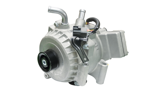

    I suppose Hyundai has forgot to reveal the belt efficiency as superior to Prius ICE ones. :rolleyes:

    The sonata had a belt and 10.5 kw motor. This is a parasytic load, but at 65 mph a smaller one than the camry's mg1. We have no idea if the ioniq has the same system here. If it does its hardly a feature but a way to get around honda's patents. I'd wait to find out technical details before jumping to conclusions here.

    Because of belt driven accessories, those have roughly constant loses at constant rpm. Will DI and smaller displacement help it get 40% efficiency producing 8 kW at 2,000 rpm? Prius can accelerate with constant low rpm giving only 8 kW to the wheels and engine is almost in the sweet spot. DCT won't be able to use this low rpm range at all, meaning that average driven rpm will be higher for IONIQ for a given power compared to Prius - smaller displacement engine but driven at 1.5x rpm. Of course things change at constant high speed on level ground.

    I enjoyed and agree with the above assessment. One question:
    GasperG wrote the Ioniq's accessories are "belt driven." Do we know that for a fact?
    If so, that will be a major disappointment for me. That would mean without the ICE running, there will be no A/C, no power braking and no power steering. Those are all attributes that I have (after owning my G3 Prius) require in a new vehicle. That would be an absolute deal breaker for me, even though I admire the pictures I have seen of the Ioniq.
    Someone ... say it ain't so.

    No a/c should be electronic and the battery soc is bigger, so no ice running for AC.
    Occasionally when battery gets low the prius/camry hybrid etc will turn on the engine even when its not needed for propulsion to charge the battery. These hyundais should be no different for hybrid or phev.
    What GasperG was mentioning is the Hybrid starter generator (HSG)(starter/alternator) in the sonata hybrid is connected with a belt. This may also be true of the ioniq. We don't know yet. The single large MG may do battery charging. I would not rule out that the ioniq uses this same system as the sonata with a large 35 kw MG clutched between the motor and transmission and a smaller 10 kw HSG belted onto the motor to start the engine and work as an alternator when the engine is unclutched until we get more details. The HSG simply is a parasitic load when it is not starting or generating power. The HSG is similar to what gm used for its eco models which were stop start or mild hybrids depending on your point of view.
