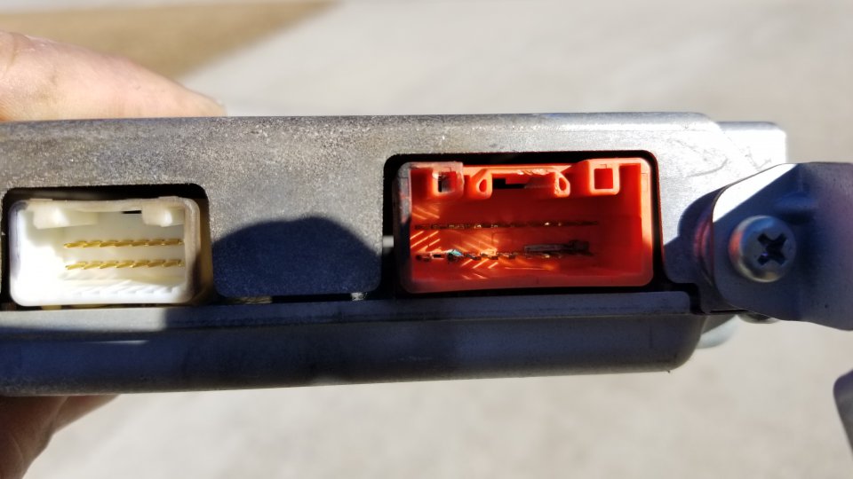

    Not really, but torque may be able to get you closer if you look at the static block voltages, and again while accelerating and braking
    Give the thrown DTCs, you should do a visual inspection of the HV battery ECU and associated orange connector for corrosion. If you find nothing there, then continue into the HV battery and look for corrosion on the voltage sensing wires that attach to each module.

    My orange connector looked like above (second pin from edge broke off), and replacing the ecu fixed the problem.
