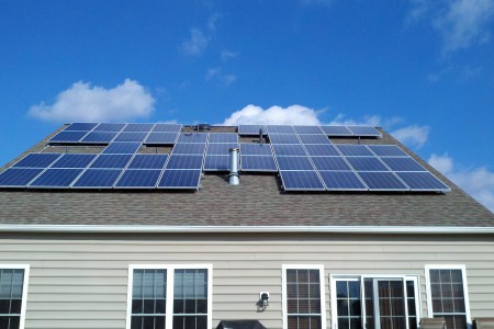

    I will give you few pointer for your PV system proposal and selected contractor:
    I hope that you will not have a PV panels installation with holes like this one, (picture from the same company you are contracting) vents can be moved.
    Ask for the quantity of NABCEP certified installers they have on staff and actually shows up for work to the field, so far they advertise for only one. Certification tags?
    Have they made a structural roof load study and project for your install? I had an architect showing up at home and plans drawings.
    Do they have their own electrical contractor supervising their jobs?
    Do they use safety gear to work up on the roof planes?
    Will they store the proposed merchandise for installation in your property until install time?
    How about workers and installer's insurance on your property?
    Will they carry away all disposables after work every day?
    The list can keep growing very fast......

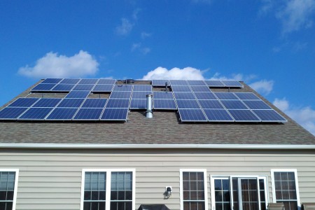

    One of our neighbors went (grid tied) solar last summer- I see his array every night on the way home from work :cry:

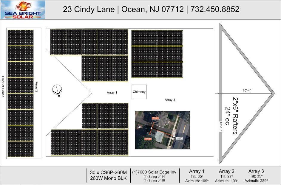

    Rob, CS6P-260M with black frame. I bought this house last April and do not know the age of the roof.
    The condition looks good and the solar guy confirmed it. The panels also extend the life of roof, I have been told.
    $1k down already. $12k first payment before ordering material. The last $12k upon completion of the install.
    This is the final design of mine.

    It is really quite amazing to think that PV can prosper in NJ and 109 degrees orientation :)
    Ridiculous

    Here in SoCal, we have a clay tile roof on our 12 years young home. I was concerned about roofing issues due to the very delicate nature of clay tiles, so the company I went with is both a roofing and solar contractor. They know what they are doing. (I hope!) My city approved the mechanicals with minor changes.
    That array looks like a QR barcode. :)
