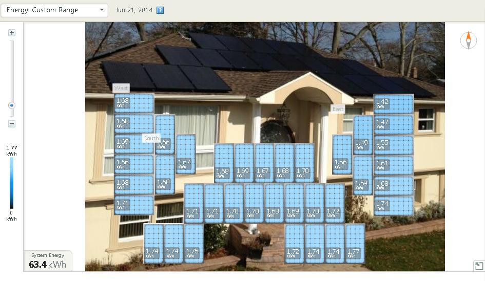

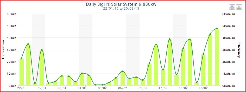

    USB, you will have to realize that today, was an EXCELLENT winter day for PV solar energy production. I'm posting my last 30 days......
    NOT such a great 30 days thanks to snow accumulation and extremely gray days.
    I passed 16 days in in the negative side

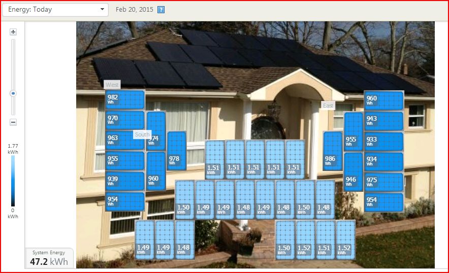

    Are all the panels the same size? What is their output rating?
    So the E/W panels produced about .95kWh each and the South facing panels produced about 1.5kWh each?

    My panels all face east, because that was the largest uninterrupted roof surface on my house, and least likely to get shaded. If you want to estimate how much power you can produce, the NREL has a nice calculator. According to that, I'm losing out on maybe 10% more production if they were facing south. I'm sure it will vary widely by location, however. I think here, the east/west panels may do better in the middle of summer; I seem to recall the calculator telling me that in addition to 10% less production, the difference between summer and winter was much greater with the easterly panels. East-facing panels also have the (tiny) advantage of getting power while the air is cooler - and solar panels are slightly more efficient when they're cool.
    One interesting thing that they can do if you have panels facing east and west is to make your inverter rather undersized; for example, mine is a 3 kW inverter, which can handle up to 2 kW on each of the 2 strings that can be connected. (So 2 kW on one string, 1 kW on the other, or 1.5 kW on both, or whatever.) So if you have 4 kW of panels, half facing east and half facing west, you can still hook them up to a single 3 kW inverter without losing anything - because the east-facing panels will peak in the morning, and the west-facing panels will peak in the afternoon. You'll stay under the 3 kW total limit because each string will peak at 2 kW at a different time. Your installer should be able to figure out if that gives you any sort of an advantage in sizing the inverter, or if there's no benefit.

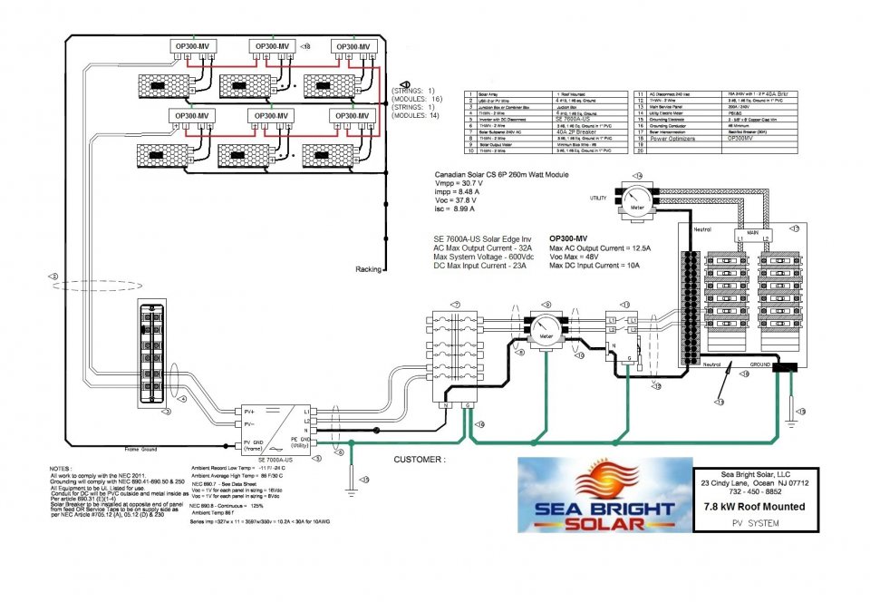

    The scope of the installation
    38 × 260 watts PV panels with M-215 microinverters. Installation tilt 22.0 degrees (3 roof planes) South facing azimut at 180 degrees
    There is a sizable energy difference due to Winter solstice, in the Northern hemisphere the Sun is considerable lower than on Summer.

    Per my line diagram, my "Solar Output Meter" is between the inverter and my main electric panel.
