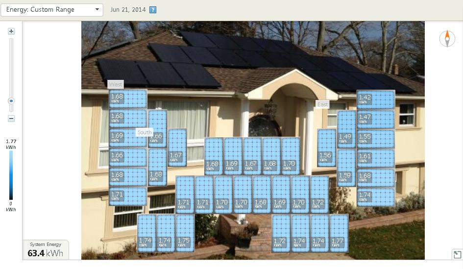

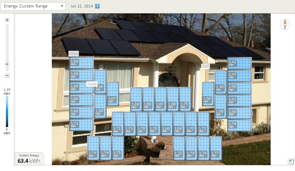

    Well that certainly bodes well for my East/West only panel situation.
    Thanks!
