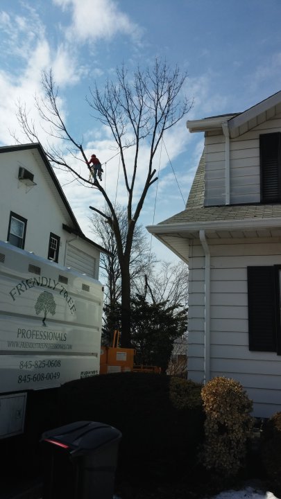

    First tree is pretty much done. One more to go.

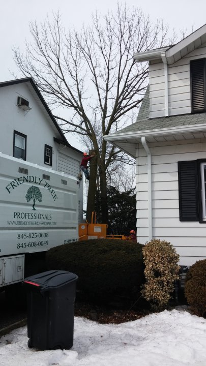

    Mostly done.
