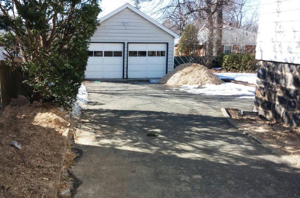

    Forgot to post the completed pic. Two tree at the left corner is gone with stomps grinded. I have already used some of those wood chips to supress weeds.
