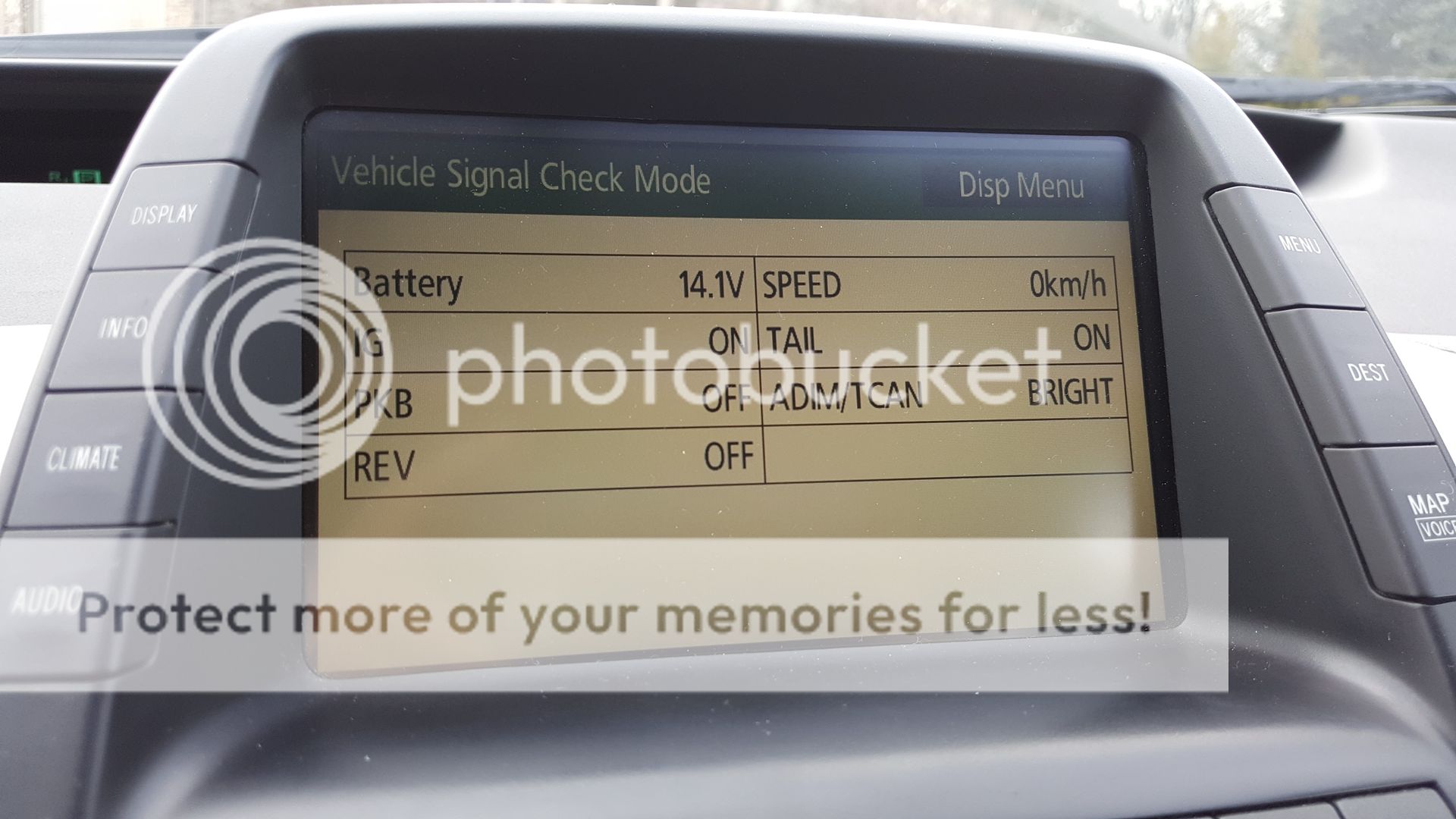

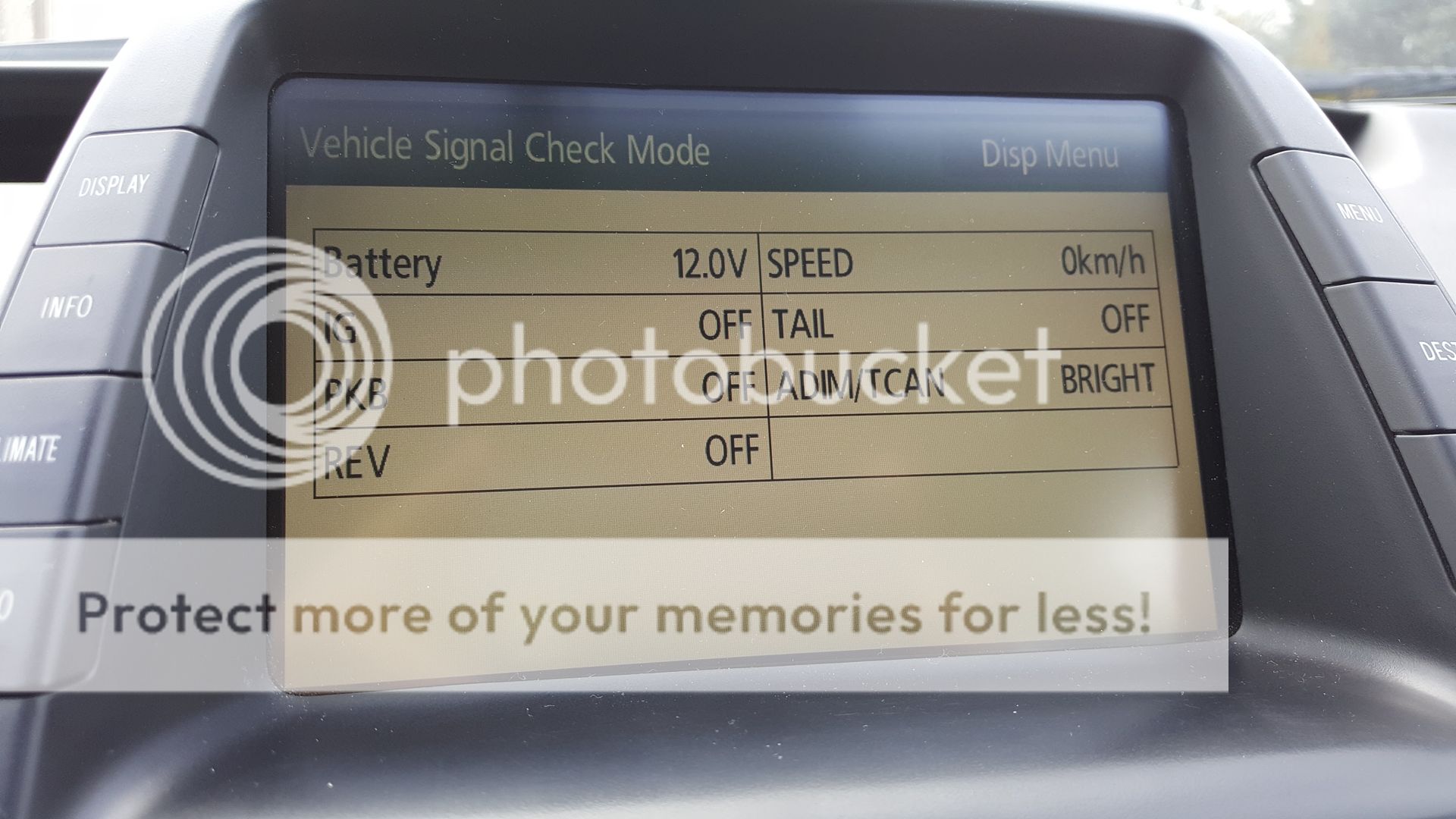

    Checked the status of my 12V battery this morning after the car had been been sitting for several hours:
    it read: 12V
    Five minutes after load it read 11.6V and after Powering the car up it read 14.1V

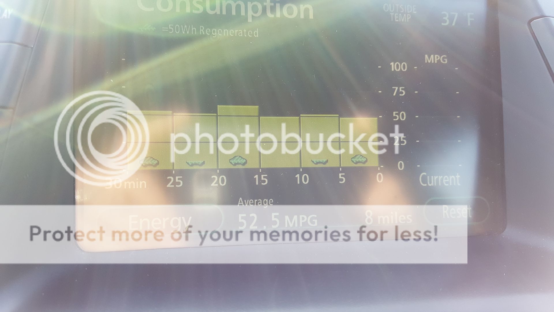

    and then I decided to go on a city ride (waste a little gas and improve my Prius driving skill). It was only an 8 Mile ride but showed me the car will give me at least 50MPG come this Spring.

    That looks pretty good for what appears to be an ailing 12V battery. It still has some life left in it, but you should probably replace it soon. My last one actually got down to between 8-9 volts at rest. I'm surprised it would even turn on the computer.

    My 3 year old 12v battery has similar charges. I think your battery is fine for now. If it gets below 12v unloaded, then I'd look into getting a replacement.

    I never know how to respond to 12 volt readings taken thus. You've gotta check it with everything off, with a digital multimeter. Under the hood jump start point is fine.

    If you want the true resting voltage then what Mendel says is true. However, it is not the most important reading when looking to see if the battery is usable. That voltage is the loaded voltage. For our purposes the MDF readings are fine, just not ideal. Using a voltmeter at the battery is the ideal.
    While this is not going to cause problems starting or using the car, it is technically flat. If you are interested at all in getting long life out of your current battery, it needs to be fully charged immediately. An OEM Prius AGM battery in good condition will charge up to 13.2 V and after resting should settle at 12.8-12.9 V. You either need to drive more or purchase a good automatic charger that has an AGM setting and use it regularly (fortnightly, monthly) depending on your driving patterns. After charging and sitting (min 2 hours), the voltage at which it settles (i. e. how far below 12.9 V) will give an indication of how far the battery is off from needing to be replaced.
    In a way these batteries are very forgiving, given their small size, as they do not have to do any heavy lifting, unlike regular car batteries that have to crank the starter motor.
    Watch out for the tell tale sign of impending demise of the 12 V battery, the momentary flash of the master caution light (aka the triangle of doom). This is the only warning light that does not light in the start up self test. The momentary flash is the low 12 V warning.

    I may be overthinking it, but as soon as you're using the car, turning it on, to analyze the battery, you're muddying the waters. How much is the battery loaded, and what's that doing to the voltage. It's like checking tire pressures while they're warmed up.
