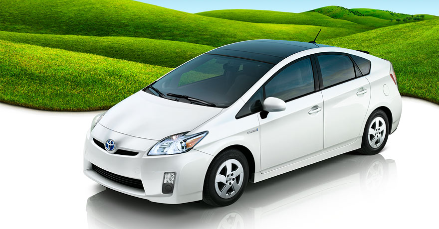

    roof looks like this?

    Yes, and the button to the left of the steering wheel is there too- with the arrow going through the car with a little windmill looking thing
