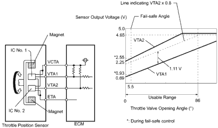

    P0121 is indeed about the signals coming to the ECM from the throttle valve position sensor on the throttle body.
    The sensor is really two independent sensors, and two voltages come back to the ECM, called VTA1 and VTA2.
    This picture is from a Gen 3 repair manual (pic was already uploaded), but the Gen 2 details are not much different:
    The important thing to see there is that VTA1 and VTA2 are not identical voltages. VTA2 is always a bit more than a volt higher than VTA1, and the slope of VTA2 is steeper.
    (The picture showing magnets and Hall sensor ICs only is right for Gen 3. The Gen 2 sensor uses potentiometers. But it works the same, in that the two voltages have an offset and different slopes.)
    The ECM is always watching both voltages to make sure that they both are in range, and that they both have the right relationship to each other; any one of those checks not passing would mean something is wrong with the throttle sensor or the wiring. There are eight different trouble codes you can get, indicating just what check wasn't right.
    The P0121 code indicates a basic problem with the relationship between VTA1 and VTA2; it means the difference (VTA2 − VTA1) was smaller than 0.8 V or larger than 1.6 V, neither of which should ever happen.
    The code is pretty specific for the throttle position sensor itself, because some problem in, say, the wiring, would probably have shown up as one of the other P012x codes that are based on simpler checks. A 2006 repair manual pretty much says for P0121 to go right to replacing the throttle body.
    Kaptainkid1 and Brian1954 like this.

    Replacing the whole Throttle body? We don't have a cheaper option like replacing the Throttle body TPS sensor? This is where I found mix information and the whole Throttle body seems expensive and an over kill.
    SM-A536U ?
  11. ChapmanF
    28,758
    19,086
    I don't think Toyota will sell you the sensor except already attached and calibrated to a throttle body, or allow one of their dealers to try that. That might not mean you can't try yourself, if you find the sensor somewhere.
