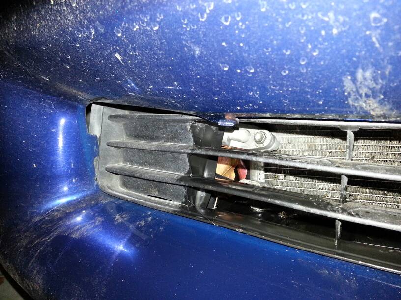

    A stupid possum ran in front of my 2010 prius going about 30mph on the outskirts of town at 2 am.
    At first I thought nothing of it since the car seemed unaffected but decided I better look.
    On the right front I sustained about a 3 inch crack on the bumper but worst of all some line was spewing "in a mist" what seemed like freon or something similar... It wasn't hot or cold especially but was nasty to breathe.
    At first I figured it must be the air conditioning line but then wondered what else it may be?
    It's Christmas so I can't have it checked and don't know if it's okay to drive.
    I did drive another 35 miles or so to get home without events... No warning lights etc, nothing is pouring out and all my fluids under the hood seem perfect.
    Could it be inverter cooling? Transmission?
    In this picture I think it's the "top" line going into the radiator in this picture. "located lower left radiator as your facing it"

    Sounds like the air conditioning. The hoses are located in the front.
    Here's a view on the 2010.
    Since you drove it home I am guessing it was not the brake lines that got ruptured.
    The inverter cooling fluid is the pink radiator stuff. I just bought some so I confirmed with the Toyota parts dept. it's the same as radiator fluid.

    If it was misting it was high pressure so likely the AC system.

    Thanks... The makes sense... There is residual fluid on the grill... Maybe 5 tablespoons worth.
    Think I'll not run the air to test.. Right now it's in the 30s outside so no need....
    Thanks for you guys input... I found another blowup, it labeled it the condenser pipe.
    Just didn't want to hurt that inverter!

    Get it fixed real soon, it's not good to have the AC open to the atmosphere. The moisture it picks up from the atmosphere and that can cause problems. The residual fluid might be AC lube which is in with the freon or it might be possum juice.

    Had toyota look at it today.
    What I thought was a radiator was actually the air conditioner condenser behind the grate.
    My fear of turning the ac button on was unfounded as it simply wouldn't have turned the compressor on if the fluid is out or too low.
    Labor is about $250.00 plus 7-800 for the condenser unless I use an aftermarket or used.
